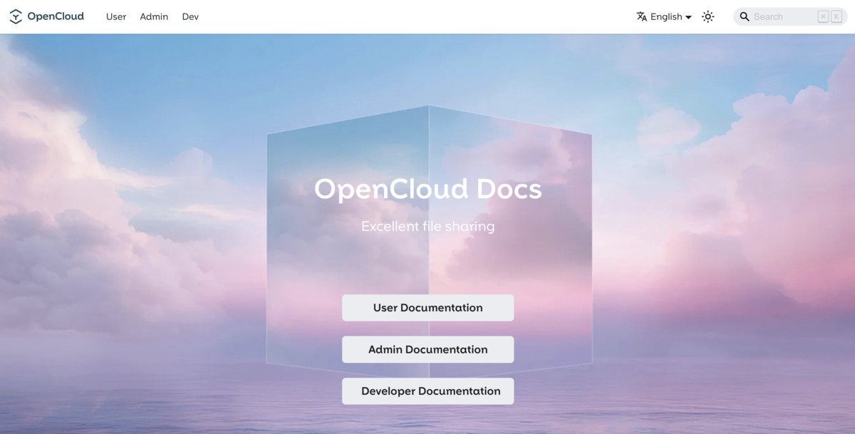

This seems to be the closest open source app to Google Drive. Looks super promising. Would love to see this in the app catalog!
The other file share / management apps are, IMO, a bit “jenky”, and a lot of us don’t want the overhead of NextCloud.
