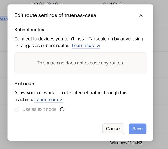

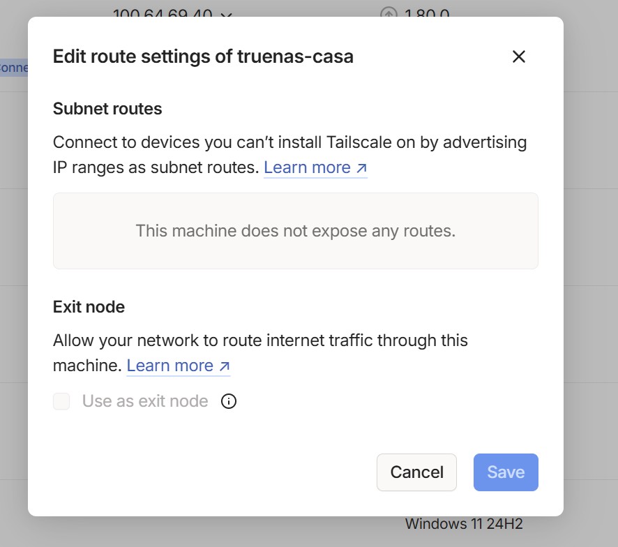

If you set the app to advertise exit node on Truenas, on the website under machines you should be able to click the menu for the machine and select edit route settings. The second section should be exit nodes where you should be able to turn it on as an exit node.
The exposing routes message seems like it is from the subnet routes section not the exit nodes section. The exit nodes section is below the subnet routes section.
Can you share what you see in the exit nodes section?
I also tried it on a second server I use as a test server, and the result is the same. I’m probably missing something.
Can anyone help me? I’m getting this message in the Tailscale dashboard. What can I try?
This device isn’t advertising itself as an exit node. Please run Tailscale up again with the --advertise-exit-node flag to enable this option.
