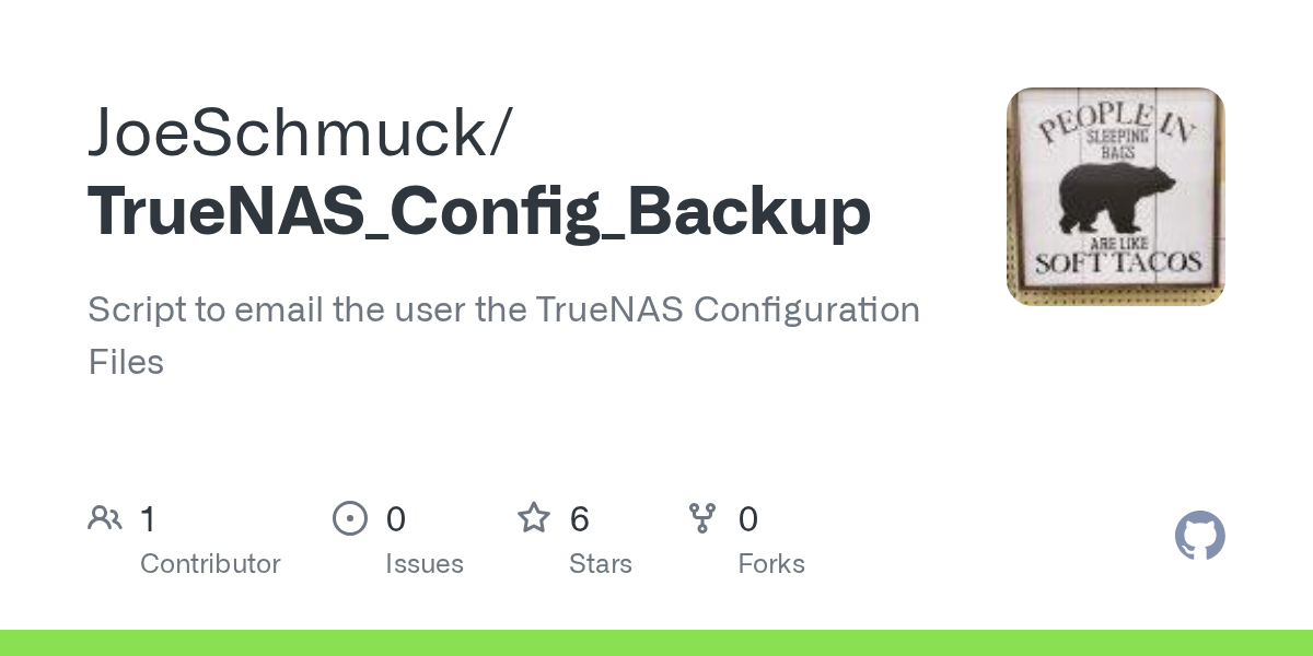

Look at my signature, there are links to Multi-Report and TrueNAS Backup. TrueNAS Backup only send you a copy of your config file each time you run it. Set a CRONJOB up to run it weekly, or however often you desire, and you will have it in your email shortly afterwards.
This feature is part of Multi-Report which is also a nice tool, it does a lot more than sending you your config file.
