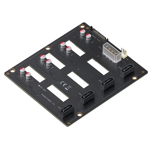

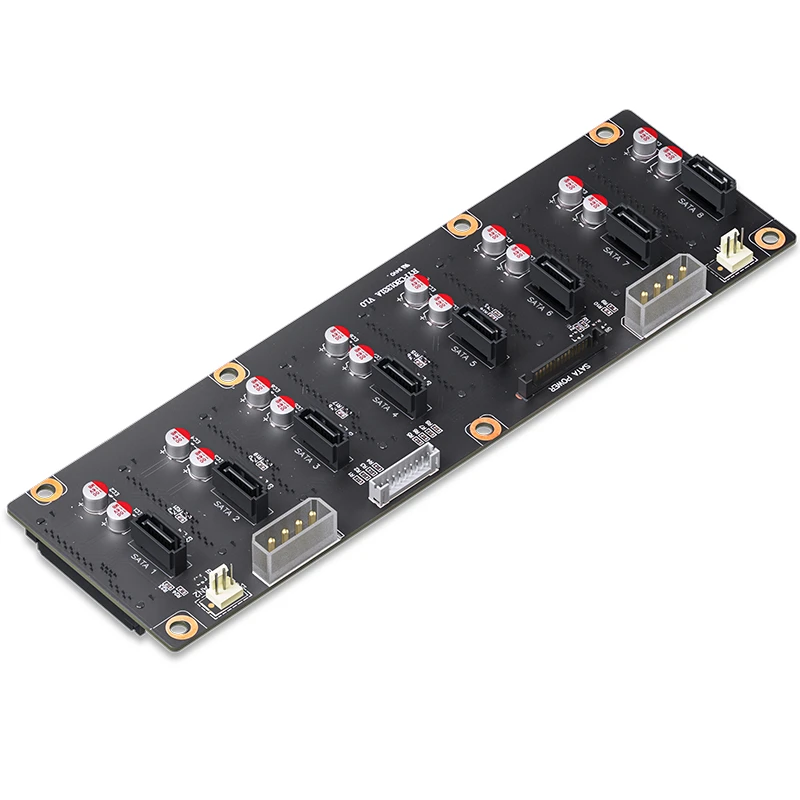

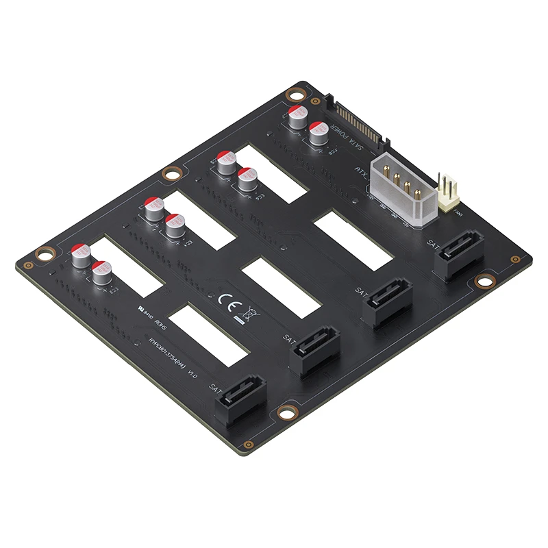

75 cm should be within specs if backplane traces are short, but I’d be wary about these, especially if the problematic drives are behind these cables. I concur that using SATA cables from the motherboard could help.
If possible, yes indeed, as double duty will put maximal stress—and extend the duration of both operations, but it is possible.

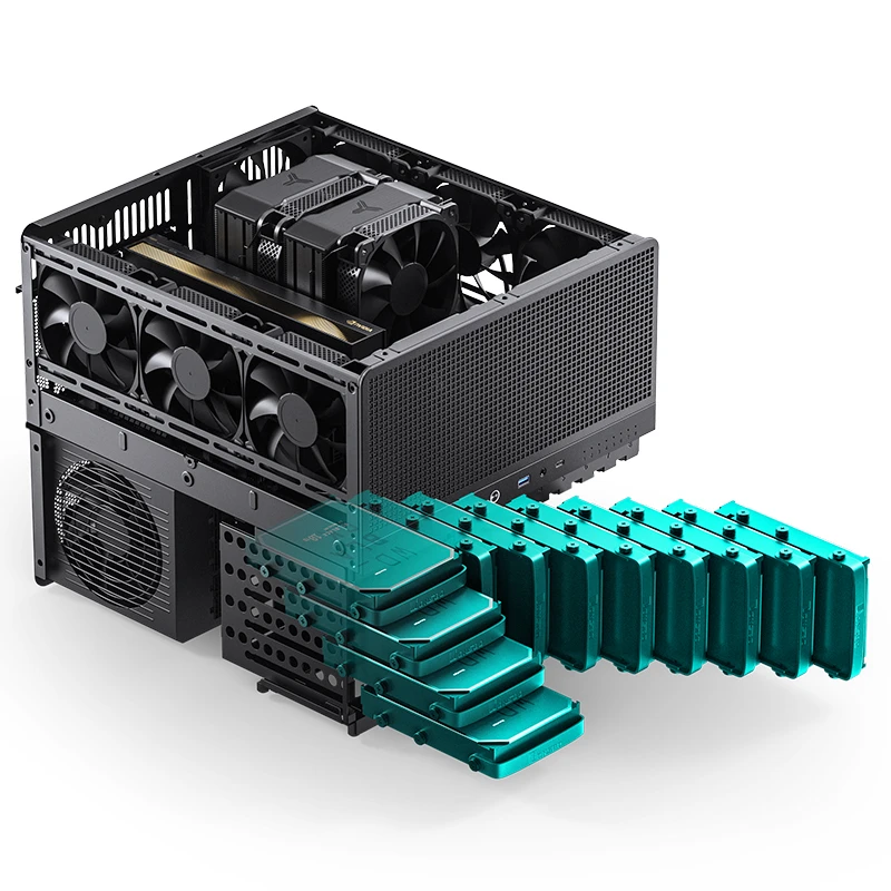

That, unfortunately, is NOT possible. Jonsbo N cases in general appear to have poor drive cooling due to the use of consumer style fans to try and pull air from behind a backplane, and the N5 puts the PSU behind 4 of the 12 bays so for the leftmost drives there really i no good path for air flow.
The 8 vertical drives behind the half-height backplane on the right may enjoy some air flow from the two 120mm fans:
But the 4 horizontal drives can hardly have any joy through this, with the PSU just behind:

yes airflow is suboptimal and worse than I imagined when I decided on the case. I have two Noctua nf a12x25 in the back running at a 100%, drives are always at roughly 40-43 degrees and at roughly 50-52 while a scrub happens…. I think this is far from ideal but not absolutely terrible but I might be mistaken …
interestingly the physical placement of the drives doesn’t make such a big difference (as one would believe from the layout of the case) drives are normally all within 2-3 degrees of each other …. also all drives that reported errors were on the board with eight drives. To be precise the drive that originally faulted was in position 6. I added the replacement that I received from Seagate to the same slot. There this replacement also faulted as I described. Two times. The first time the resilver completed. The second time when I shut down the server to investigate the drives right next to it ( so position seven and eight) reported the errors I described. The drive that is being resilvered is now still in position 6 but has no longer reported any errors. The drive that now always reports errors was initially in position 7 (therefore sharing a cable to the HBA with positions 5,6,7,8) but I now moved it to position 1 and it shows the behaviour that I told you about and no longer shares a cable with 5,6,7,8 but with 1,2,3,4
