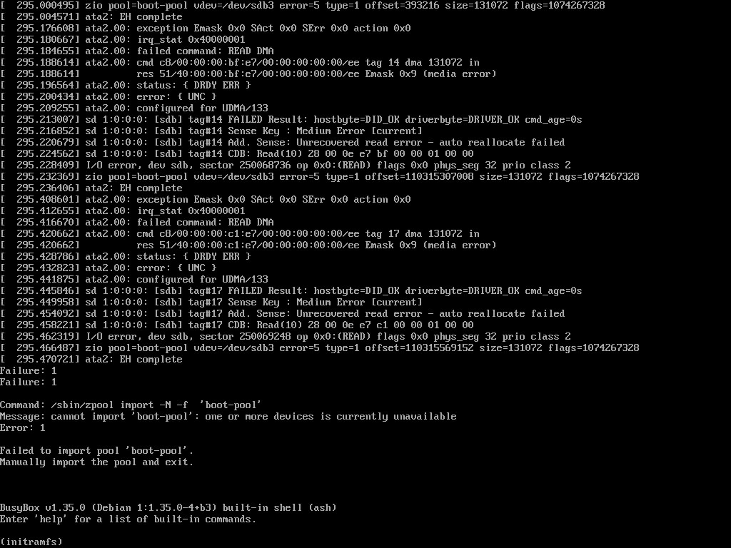

Smart found errors on a 128GB sata ssd that was setup as a boot mirror
Sata0 : Patriot 210 128GB
SMART Status Bad, Backup and Replace
Press F1 to Resume...
Press DEL to run Setup
Press F11 to invoke Boot Menu
Press F12 to boot from PXE/LAN
DXE--AHCI Initialization.. A2
Nothing was responsive. If I did get through, it crashed after a few minutes and would start over.
At this stage I pull the first drive hoping the second drive would pickup the slack and boot, no joy. It doesn’t give me an F1 to resume, but just spots back some errors.
I came across a few discussions about Scale and updating the bios in similar situations. Despite the server running for months prior to this. So I updated the Supermicro bios from 1.2 to 2.0a just to see if I could get into the setup menu or to another screen. Still crashed.
So I pulled both drives, connected them to another machine and tried to run tests, but the drives magically lost their smart reporting.
I do see an UFI partition on each of them.
I ended up installing the TrueNAS on an M2 and re importing the config. That took dramatically less time than troubleshooting the boot mirror.
