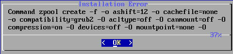

Christ! That bot training was more involved than I expected :smile:

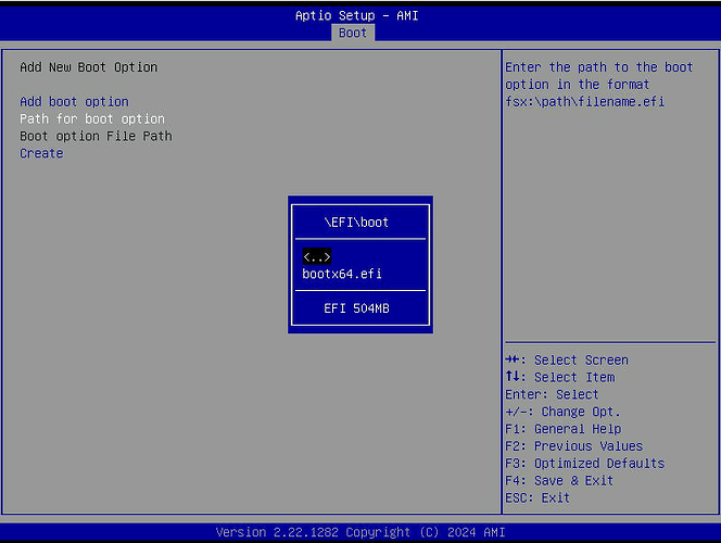

And some more
Even tried manually adding the boot option, allowed me to add the boot option, but even manually trying to boot from it from the bios override didn’t work, still get the Welcome to GRUB screen.

I have tried physically removing one of the two onboard nvme cards, wiping the remaining nvme using dd if=/dev/zero of=/dev/nvme0n1 bs=1M count=100 and then installing TrueNAS Scale 24 again. Same result.
I then tried reimaging using rufus, ensuring UEFI was chosen and dd was the copying mode. Still no dice.
Trying to install onto a USB drive next, will update this page afterwards.
USB installation failed…
