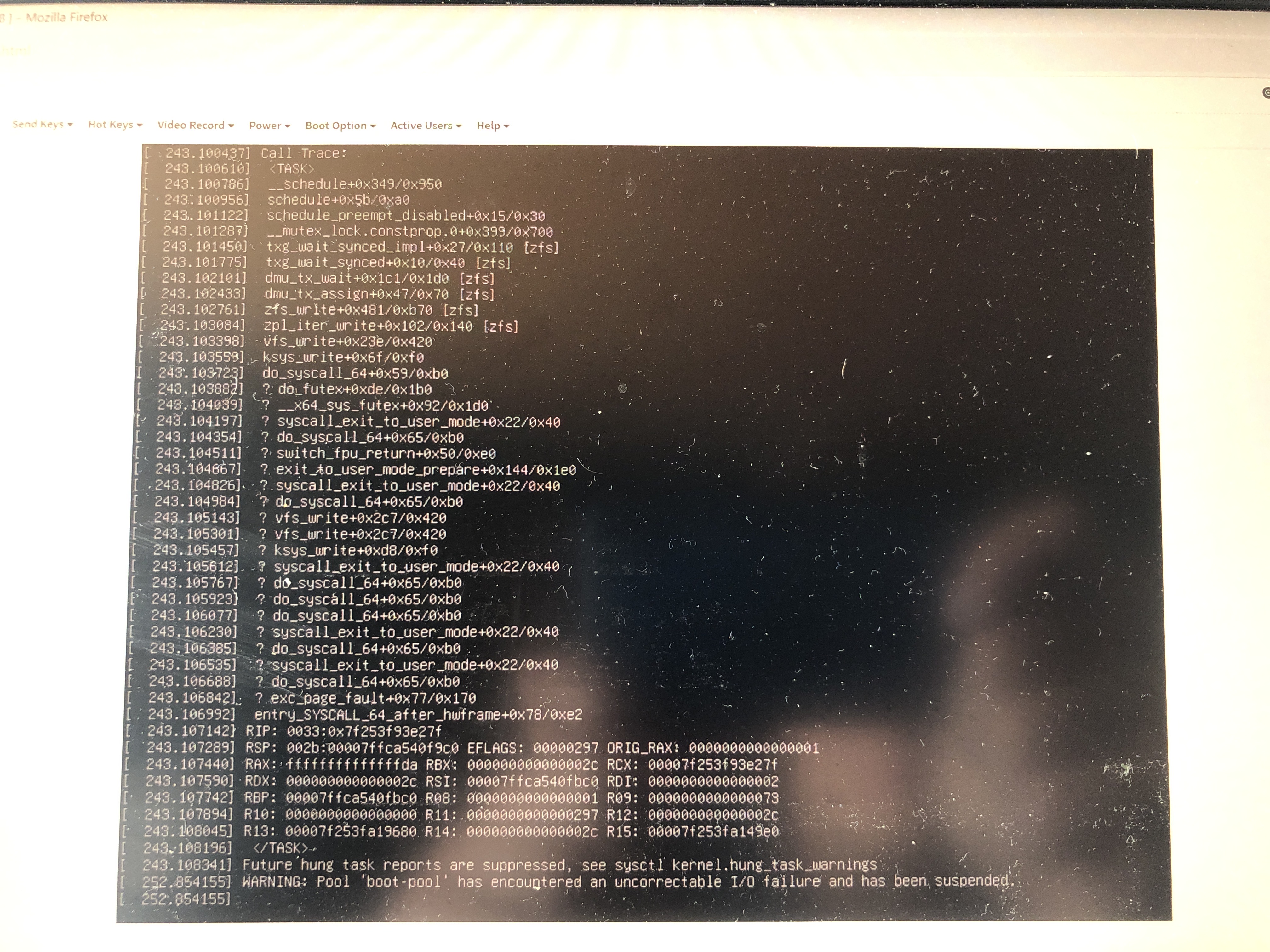

I’ve attached a picture of the console. After the last line the nothing happens any more.
I think the VM has gone through every sata connection, even the boot device directly from the controller, but have not found a way to prevent this. Not with the debugg mode or anything.
Is there anything I can do instead of reinstalling Truenas itself?
