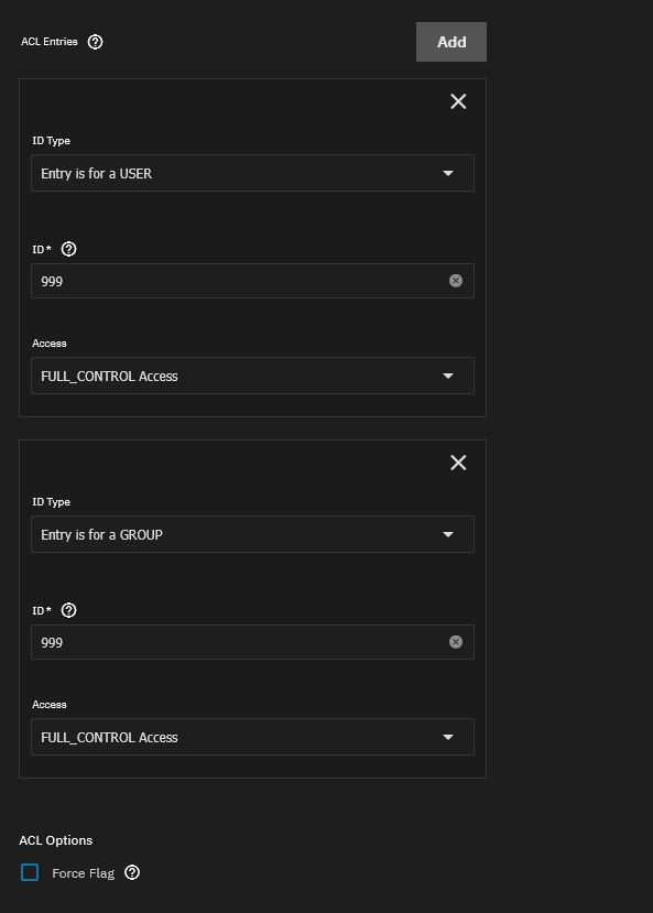

Afaik, I need MariaDB first for Bookstack, so I installed it from the official app list. But I´m not sure it´s configured properly.
But MariaDB is at least up and running.

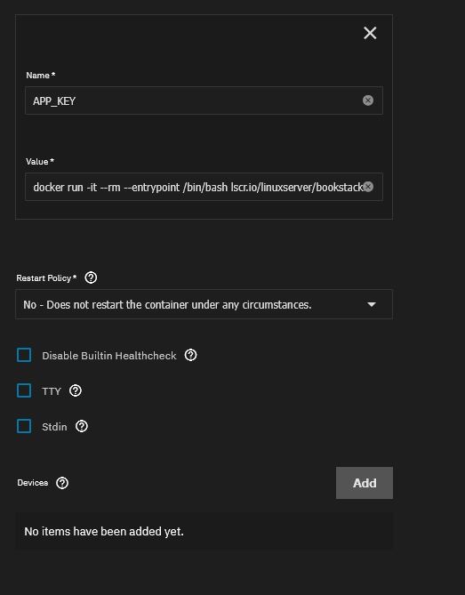

  3. One problem I had was with the Bookstack environment variable APP_KEY. In the Bookstack guide, it says that the session encryption key needs to be generated with docker run -it --rm --entrypoint /bin/bash lscr.io/linuxserver/bookstack:latest appkey . Do I run this in the Bookstack container shell? When I tried this, I get docker: not found.
The Bookstack App however is starting up, but I cannot access the WebGUI. Neither without reverse proxy (accessing via TrueNAS IP:Port15000) nor with reverse proxy Nginx (just showing 502 error - bad gateway).

At your TrueNAS shell, run sudo docker run -it --rm --entrypoint /bin/bash lscr.io/linuxserver/bookstack:latest appkey. It will produce output like base64:BjPmlmNurOj/bRbPv/5LszyY6ctdrsy4mr0LD79HiMI=. Save this somewhere.
Then go to Apps, Discover, click the kebab menu, and select Install via YAML. Paste in the compose file I linked above, and make the following changes:

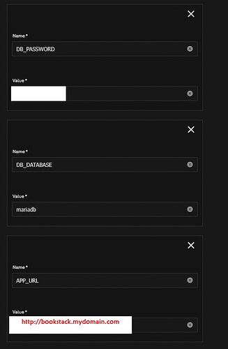

May I ask one other question - I can access Bookstack locally now, but accessing it externally does not quite work.
I have a subdomain bookstack.mydomain.com targeted at my static IP, router portforwarding it to Nginx.
Just like my Nextcloud reverse proxy, it points to https://truenas_ip:6875
But I always get a 502 Bad Gateway error. Is there something I can change in the compose file? Change APP_URL to my subdomain?
That’d be my guess. I hadn’t touched Bookstack before this afternoon, so really can’t give much guidance about it.
