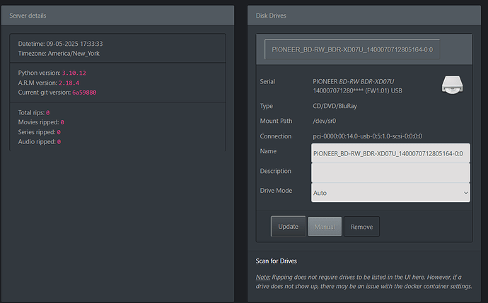

And now it is working and I didn’t change anything?
That’s so weird.

ARM is seeing my drive … it’s recognizing the DVD but not doing anything … shows
[ARM] Starting ARM for DVD on sr0
But isn’t doing anything … :frowning:

Holy moly, that worked for me as well! With the app running, I power cycled the drive and boom, it showed up immediately. Now the fun of figuring out why my first rip failed begins. Thanks for the tip!
