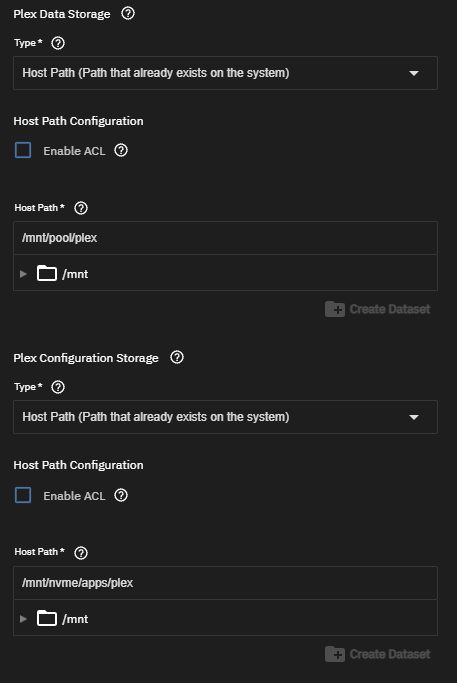

  • Once the migration is complete, re-install the Plex application. I set up my storage as follows:
    /mnt/pool/plex is on my slower HDDs and is where I have my media stored.
    /mnt/nvme/apps/plex is where I store my configuration and DBs on my faster NVMe mirror.
  • Once you have verified that you can access your media from the Plex Docker instance, stop Plex and go to the Library/Application Support directory. Remove the Plex Media Server then extract the tar backup here.

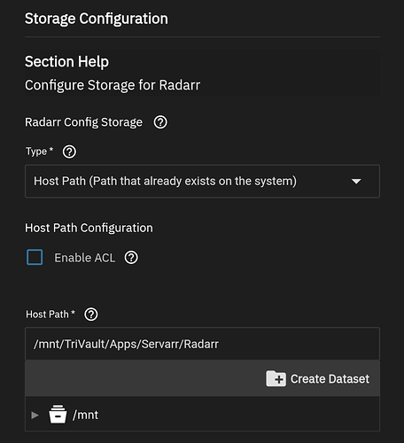

I thought Plex would be the hard one, but….sonarr & radarr are stuck in deploying. I’ve tried deleting and reinstalling a few times. There is not much to set up there, so I don’t get it. I have a dedicated nvme drive for the apps so storing them on /mnt/apps/sonarr and …./radarr.

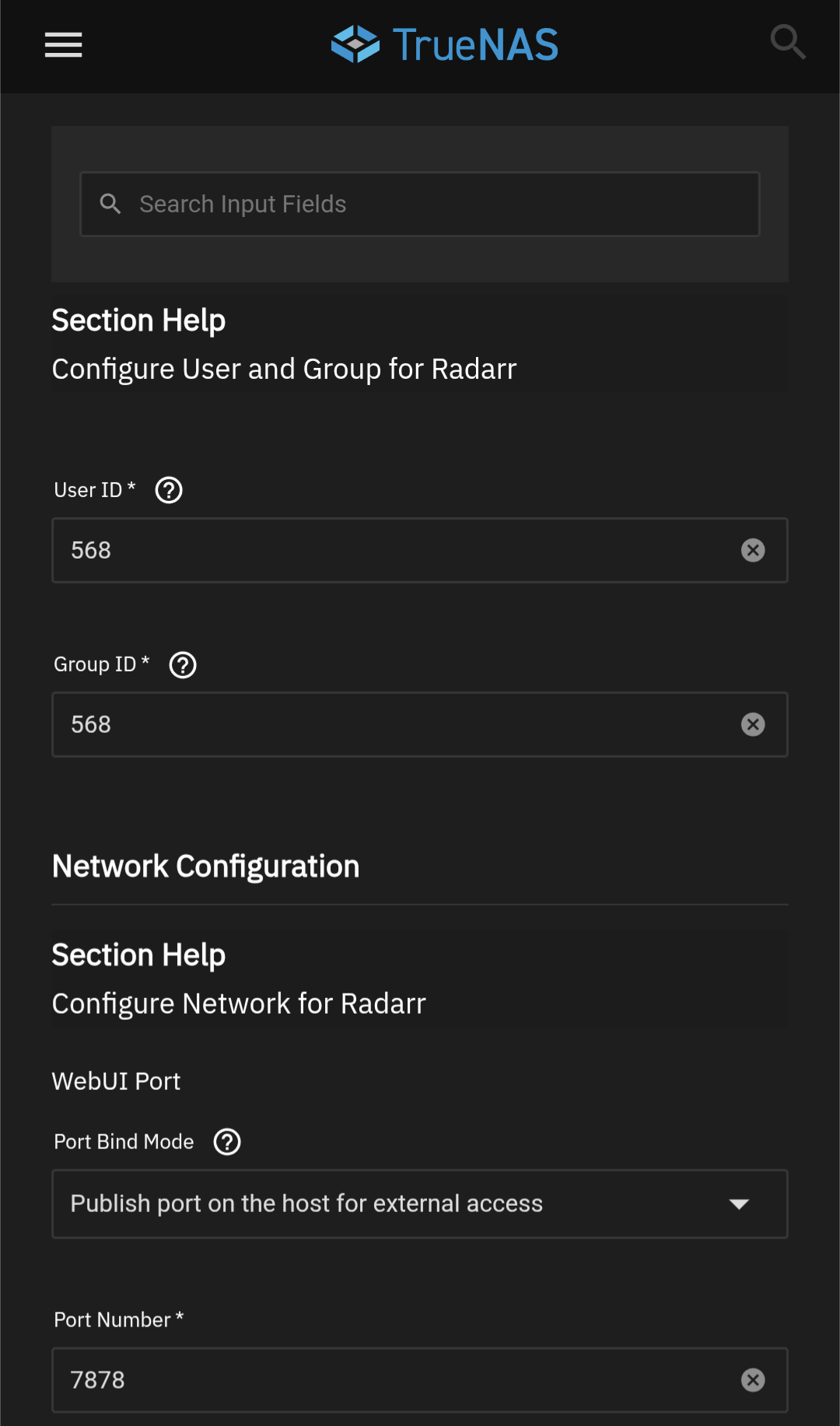

I recently made the same plunge. In addition to Plex/Radarr/Sonarr/Transmission I also had a Nextcloud instance, reverse proxy, WordPress site, a Grafana instance and an Adguard instance I had to migrate. Its been a journey, to say the least.
Regarding your app containers that won’t start, I’ve also experienced that and got pretty frustrated with the fact that they would just restart with little feedback.
I eventually settled on initially doing as little setup as possible, and making sure the apps actually boot and are working, before adding custom storage locations, changing network settings, fiddling with app ownership, and doing other tweaks.
I documented my experiences on my blog. For your reference I also added my app setup here. It might give you a clue on where you’re going wrong.

It didn’t quite solve my problem, but did get me thinking in the right direction. Before I set up plex, I created an app dataset first. Then while I was setting up plex I noticed that you could create the app data set from withing the app installation routine. So I used that technique with radarr and sonarr. What I didn’t realize is that technique does not apply the correct permissions. After reading your blog this occurred to me and I was able to fix it up right away. Really strange though that the app set up does not spit out an error or generate a log to help poor newbies like me. It just went into endless deploying which was very misleading.
