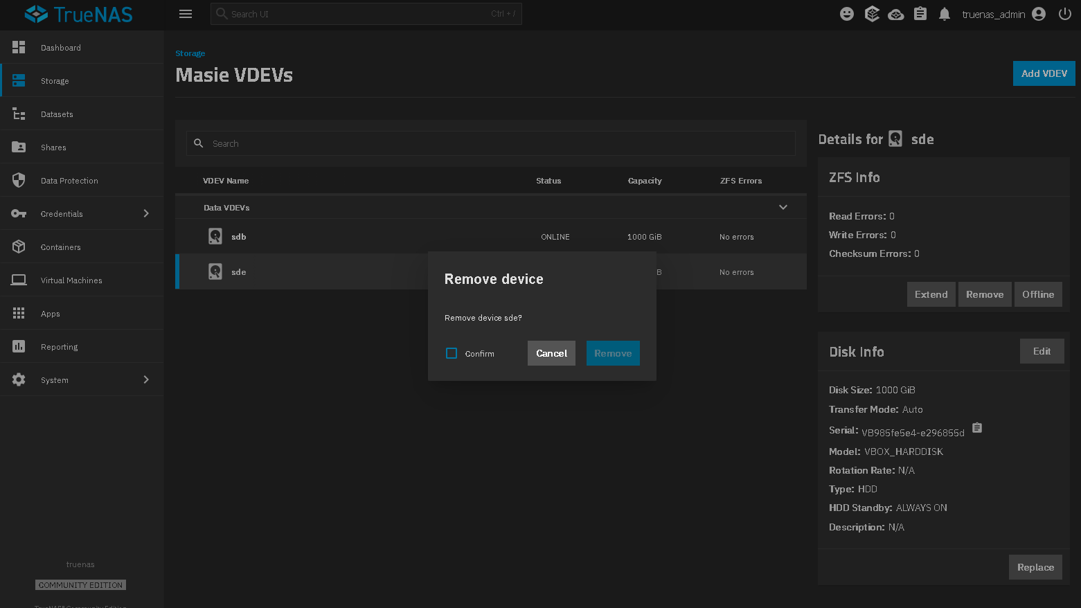

Is this any official documentation regarding removing a disk from a pool? I can only find forum posts.
You might have to change the version of TrueNAS on the docs. It shows replacement.
To Remove a disk from a stripe or mirror VDEV. (screenshots from a VM of TrueNAS 25.10)
Storage, View VDEV, select the disk, click Remove and confirm.
TrueNAS should move the data off the disk you are removing and onto the remaining disk.
