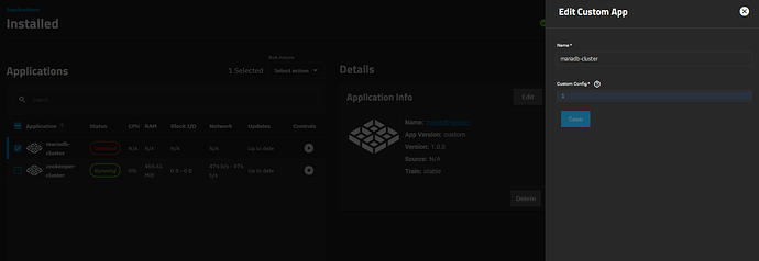

But, when I want to amend the YAML file once it is started, I just get the name of the custom app which cannot be changed, and no YAML content.

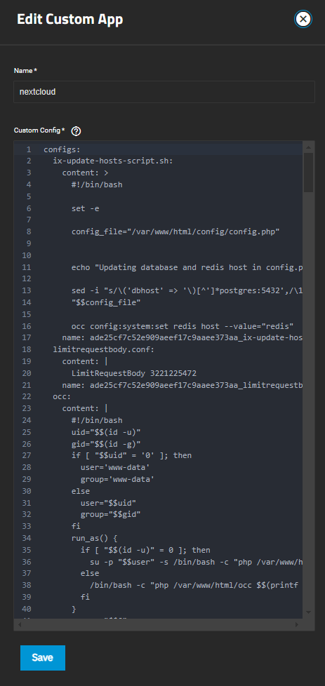

This shouldn’t be the case. For example, I just tested this with a YAML Custom App on 24.10.2
Maybe try upgrading to 24.10.2 to see if that helps, since I don’t have a 24.10.1 install to test on at the moment, but you definitely should be able to edit the existing YAML.

I think there is a refresh isssue here, if you refresh the apps page and then open the edit does it show?
I upgraded to 24.10.2 this morning, and the YAML is now getting displayed.
Thanks all for your contributions.
