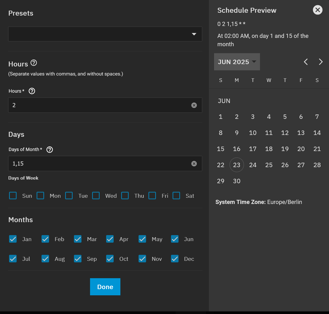

This one will run on the first and the 15 th of every month, at 2 AM.
