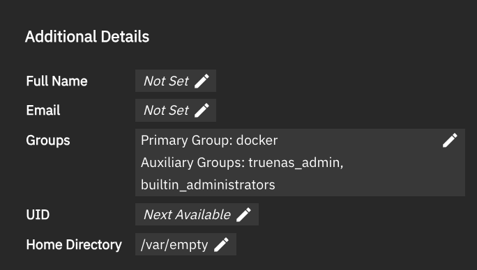

you can add in the UI (Scale 25.10.3), as long as you add it as the Primary group.

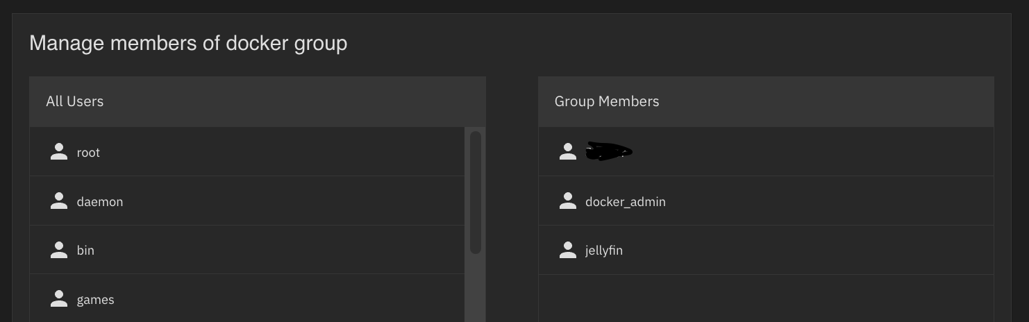

in 25.10.3.1 - Goldeye i dont see that as possible:
actually dont see anyone in the docker group even though they are being set via init script:
That is not what I see in mine: 25.10.3 - Goldeye
edit: I just updated to 25.10.3.1. No changes.
I just created a new user:
It was created normally.

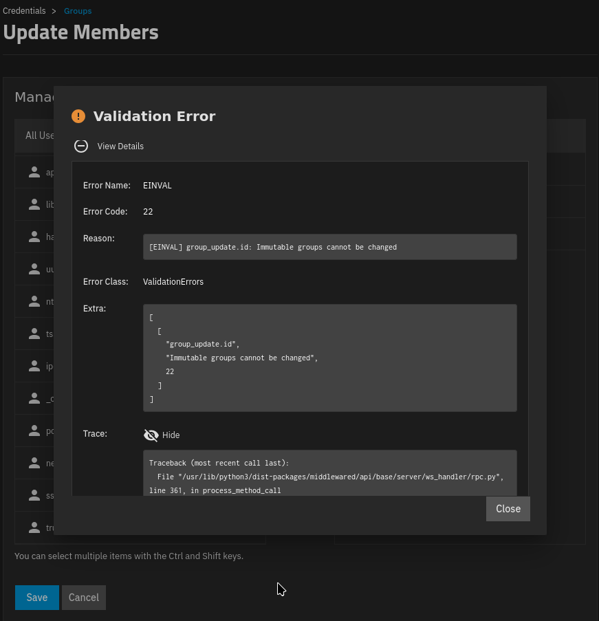

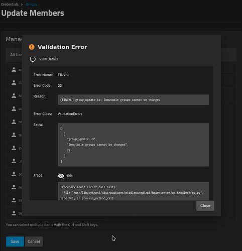

weird if i try to add members to the docker group using the group manager i get:
i clearly have users in the group, though, as im doing it via init scrips:
$ getent group docker
docker:x:999:truenas_admin,vscode
