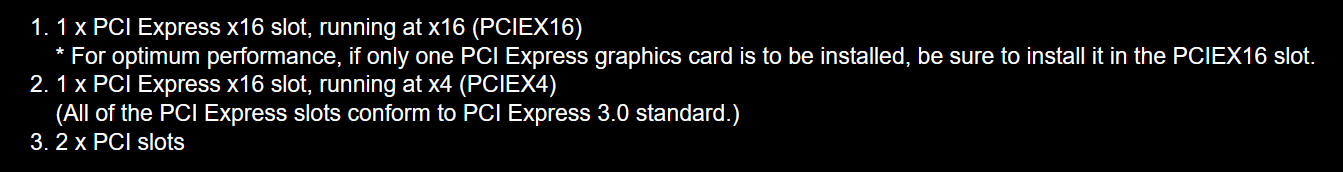

Edit: Just saw that there are several internal temperature sensors in the area, so maybe comparing values could give an indication which areas are hotter. And between the two PCE-E slots there are two PCI slots, so there is space, which probably is a good thing.
BTW, the second PCI-slot is just PCIx4, even though it is full length, so one of the two cards will not be able to use the x8 they are capable of. Not sure though at what point this actually matters.
