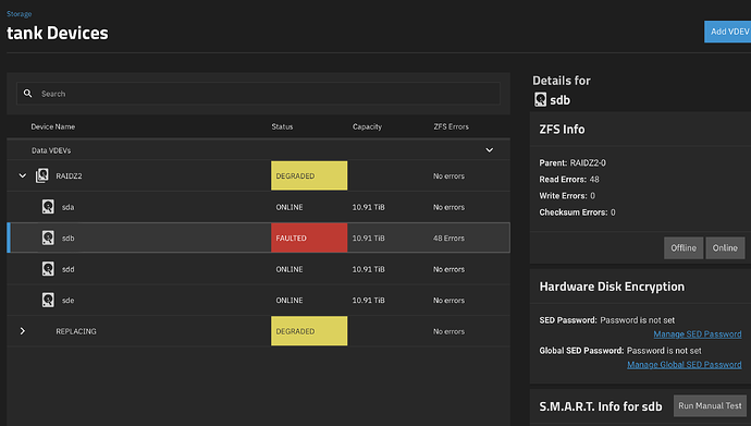

Hi guys…
Please advise, what do you think caused the drive failure, see attached.

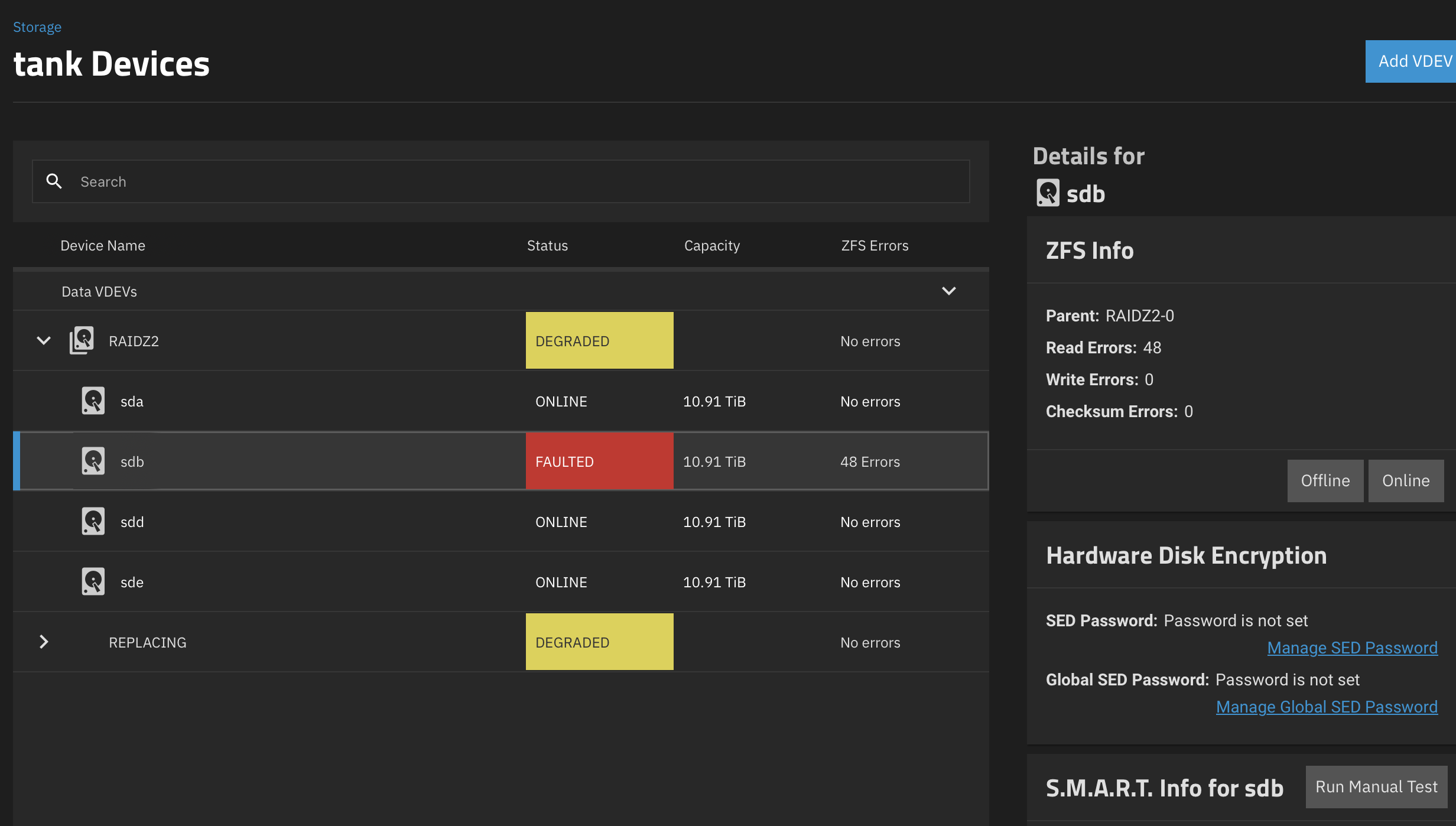

Hi guys…

Re-uploading a SMARt report.
Can see how this drive is not a problem, disk pool is reporting degraded… 1 drive out of working…
Thank F for RaidZ2.

… just realised, as much as i pulled the information, is it not based on the last smart scan… which itself was not today, was before this morning.
it’s as if this drive went faulty while re-silvering the drive that was replaced this morning.
The re-silver of the new drive is now complete… Might I try a scan of this drive ?
Do we want to somehow confirm it’s state first… confirm what the dashboard is saying, but some how with causing load on it.
