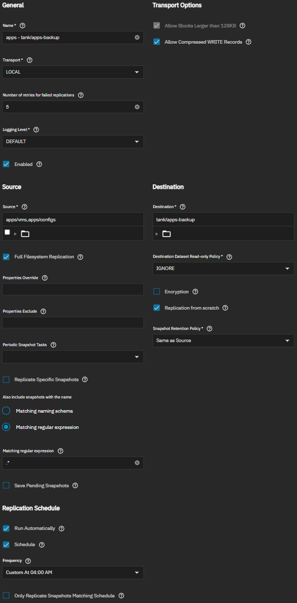

Therefore I created a replication task like this:
As described in the Truenas docs here, I think this shouldn’t even work.
However it did the first time and the whole apps root-dataset was replicated to tank/apps-backup and still was encrypted with the original key.

You need to exclude the hidden .system dataset from the source. Not sure how this is done in the TrueNAS GUI, other than selecting all children directly under the root dataset.
This is another reason why I use pseudo-roots.
Since 7 years ago, I have never replicated a root dataset. The highest level I ever replicated was a pseudo-root dataset.
Thank you! It seems to work now.
I changed the replication task to replicate the child-datasets of apps (apps/vms, apps/configs). This works without issues so far.
