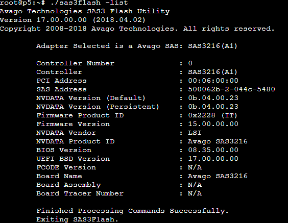

Hello, please help find an updated firmware version for this (beta/early/china) card version - it currently has 15.00.00.00 fw version.
I’ve purchased it from taobao and it looks exactly as original LSI 9305-16i card (long), but sas3flash -list gives controller SAS3216 instead of SAS3224.
It also says product ID Avago SAS3216 instead of SAS9305-16i
When I try to flash it with Broadcom 16.* firmware for 9305-16i-IT , there is ERROR: NVDATA Image does not match Controller Device ID! Device ID - NVDATA:0xc4 Controller:0xc9
(as it has another controller, not SAS3224) . Looking to another topic, “Is this HBA card legit?” , I’ve tried to flash fw from supermicro site - it flashes without errors, but don’t work at all. Red led on the board is on, and the card becomes very slow to respond, sas3flash -list says it is not operational, flashing is needed. Good that I’ve made a backup of original fw before flashing (15.0.0) - after reflashing it/rebooting, card works again.
So, is there a chance updated (16.*) firmware exist for this card? Is 15.0.0 firmware ok for Truenas?

No, its for base controller SAS3224, and my card has different one, SAS3216. It doesn’t flash

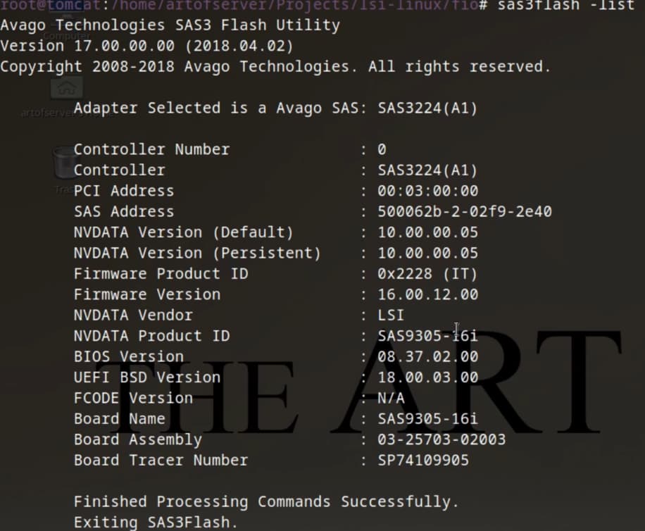

Original card info to compare

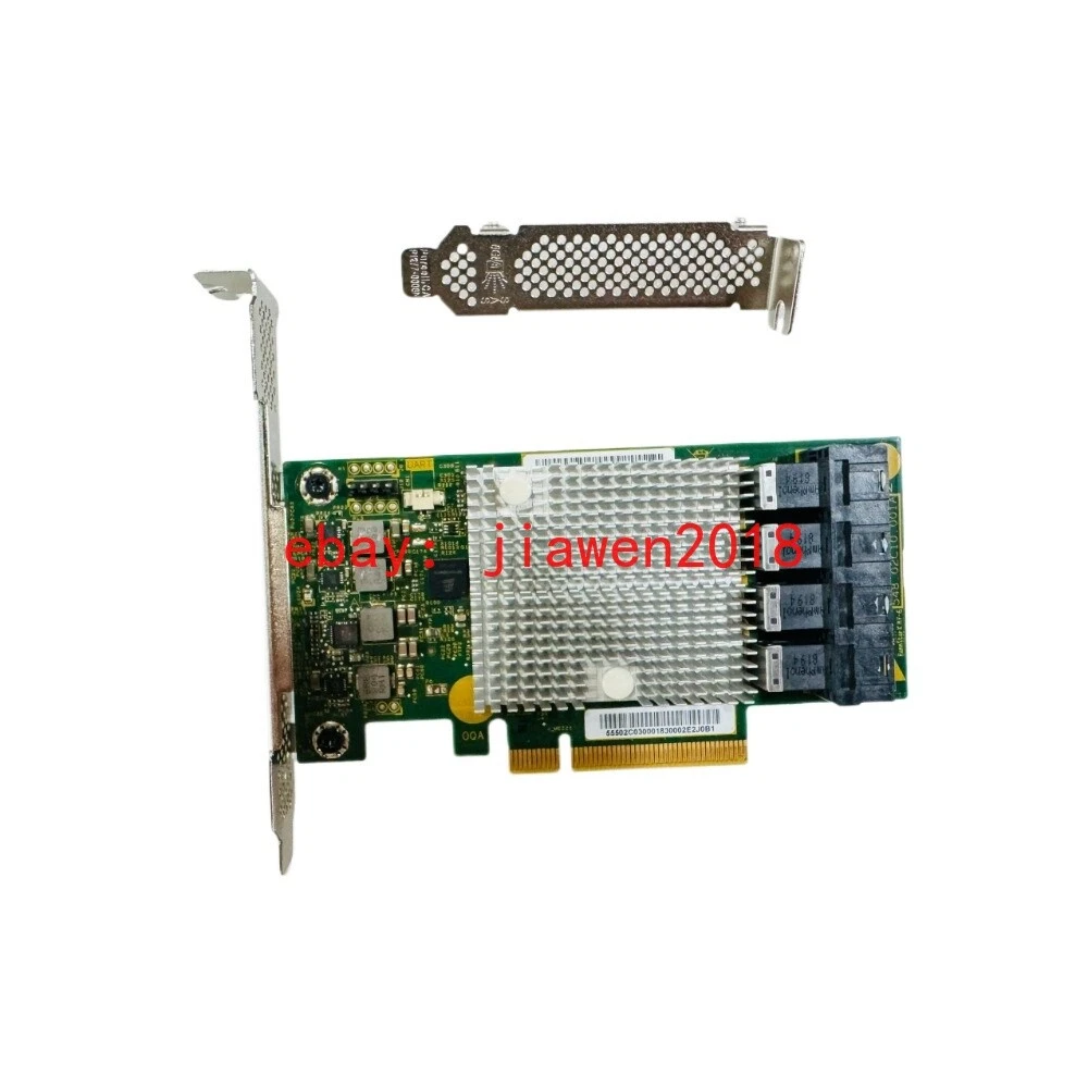

These cards are being sold by many sellers on eBay. Make sure if you purchased a 9305-16i card on eBay you check the chip version. SAS3216 chip is not the same as the SAS3224 chip and requires a different upgrade process. User Nialpo nailed this one with a copy of the original 15.00.00.00 firmware he downloaded from his card. The file is in his Mar 15 post. Using his process I was able to restore my card to working order. (see his original posts from Jan 13).

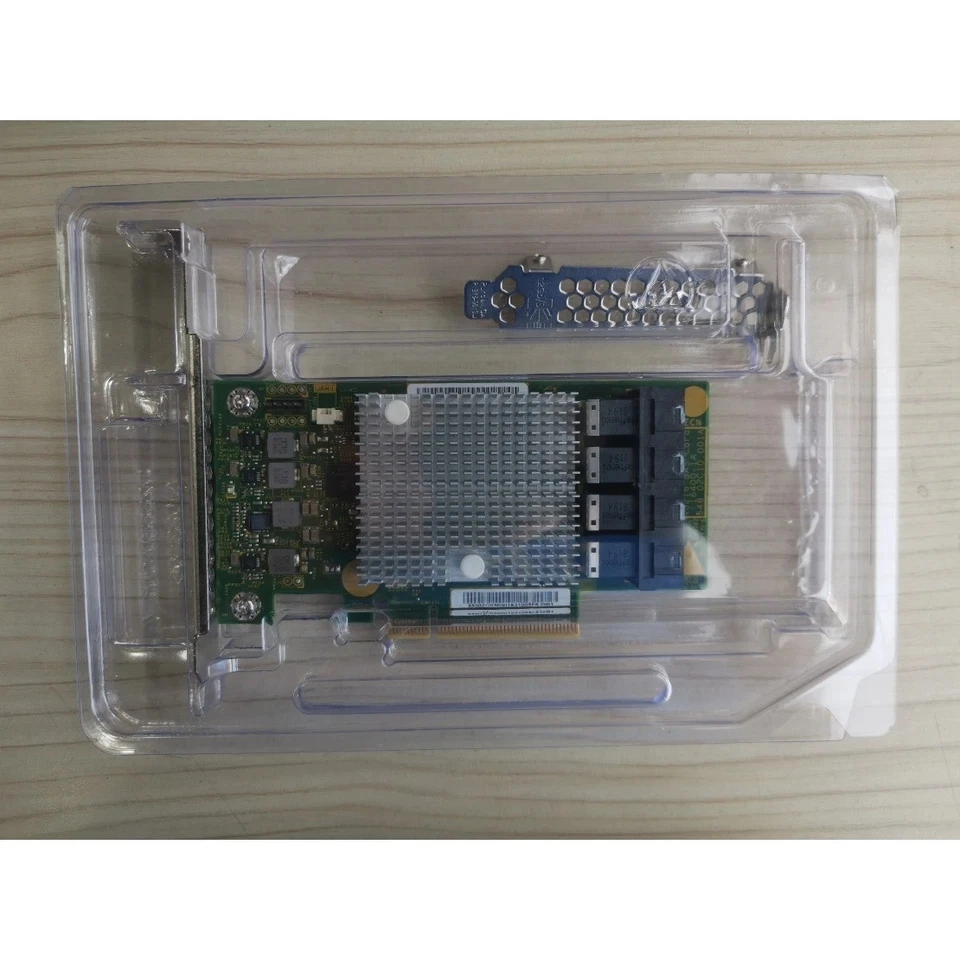

Photos

You have saved my sanity. Thankfully I had made a backup of my weird P15 firmware which I was able to restore (after a few hours failing other attempts) by EFI booting a flash tool and wiping the entire flash, because the Supermicro P16 firmware was accepted to be flashed as an upgrade but totally failed to load with many BIOS boot errors, and locked the kernel of every OS I attempted in endless adapter reset loops. I have the “long card” with notch in the heat sync for the extra ports of the 24i, and the 3216 PHY map has 8-15 disabled. Your AI patched firmware has been working perfectly. I don’t even use TrueNAS but signed up just to say thank you!
