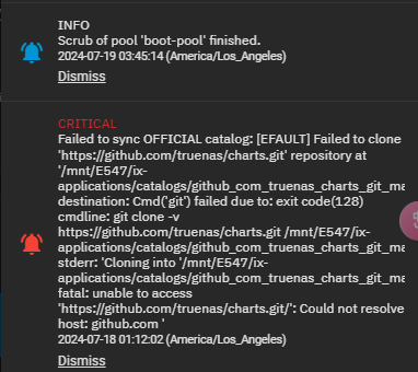

The current situation is that the page shows that
螢幕擷取畫面 2024-07-22 134202
This fault(in your screenshot) has nothing to do with the pool, it’s just because Truchsrts removed their catalogue from GitHub.

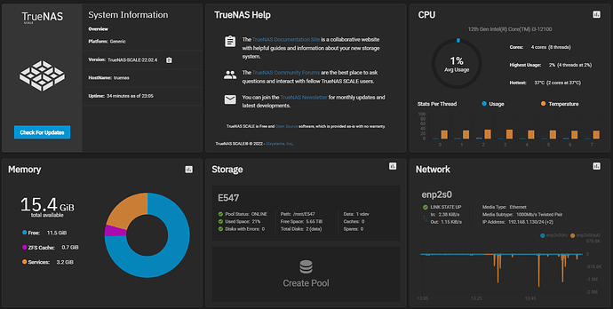

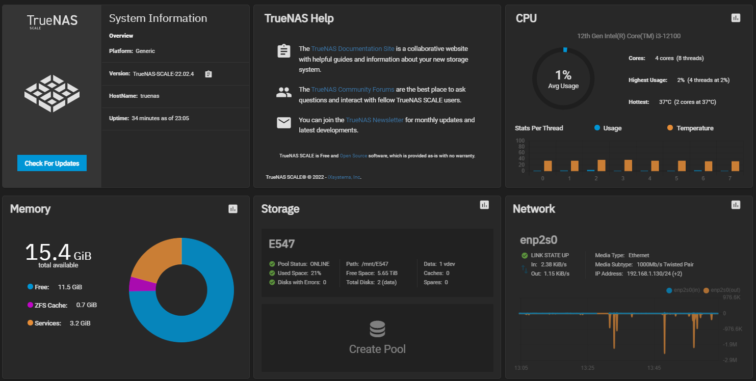

Is this it?
The second screenshot is showing Storage. You pool is showing online and about 21% used. Its name is E547 and has two disks
Server was running for about 34 minutes when you took the picture.
Does it look like there is no problem with the pool layout, connecting directly to the applications we are going to use, and I can use it ?
The pool looks fine from your screenshot. You can look at the files in the pool but I think you are fine using it.

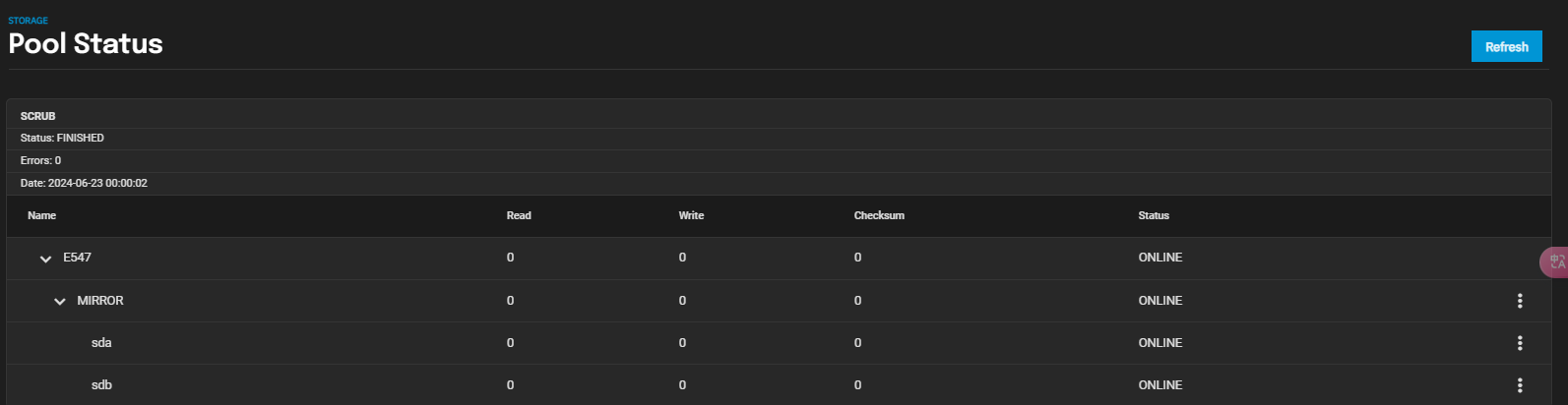

Is this it?
Yes, It shows the pool scrub finished. Your pool is a mirror an has two disks SDA and SDB. All disks and the pool are showing Online. Very good.

@yuting you in chinese? if this,you can use gitee mirror directory I created。
true chart: https://gitee.com/GTXCK/true-charts-catalog
https://gitee.com/GTXCK/true-nas-charts
