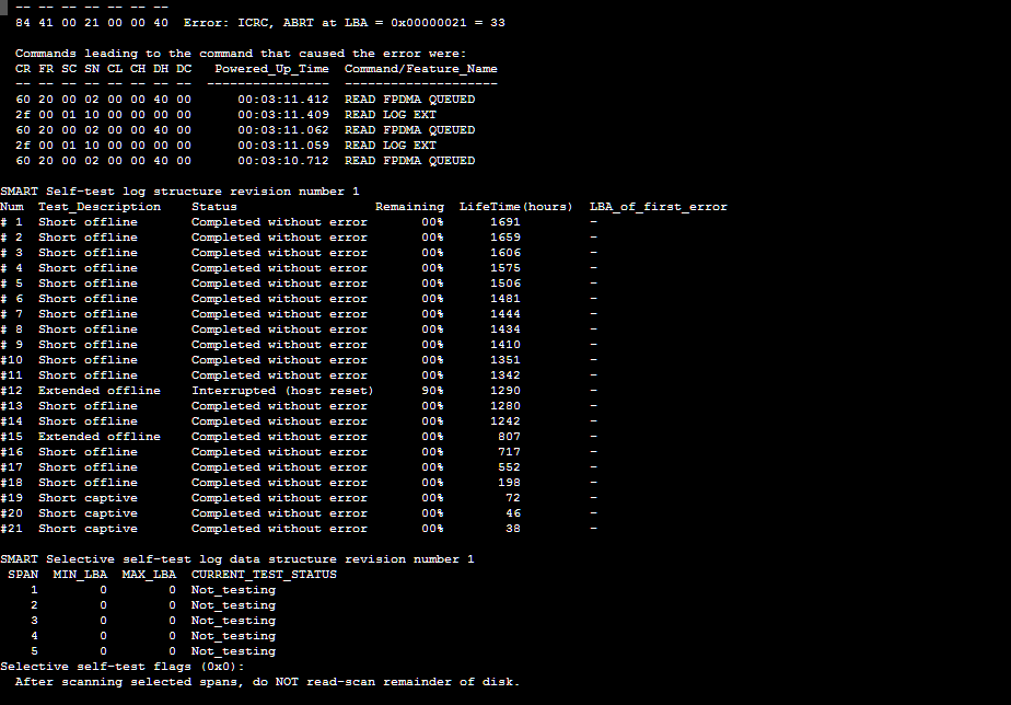

I’ve done scrub, memtest, switched every cable, transfered the drives to another rig, even made a fresh OS install without porting the config, the corrupted files always persists.
One odd thing that I don’t know what to make out of:
2 out of 3 drives reports same amount of checksum errors, 1 reports none.
And yes, they all passed long SMART test, and it’s the same 2 drives no matter how many environment factors I altered.
