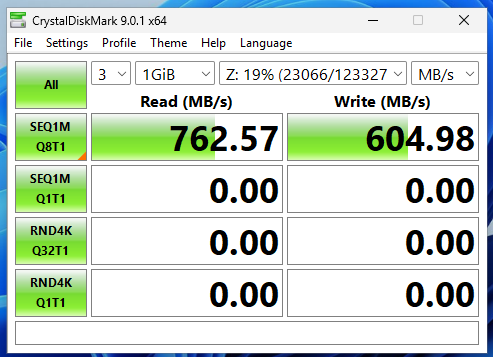

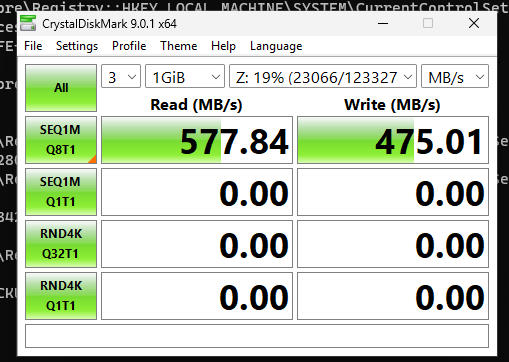

Before:
After:
This is from a completely fresh Windows 11 25H2 VM. Looks like there is still a pretty significant uplift in sequential performance from the base configuration.
