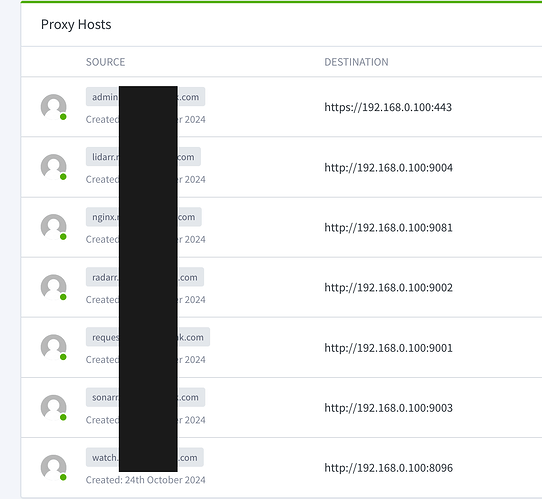

Respectfully, I think you may be falling into the XY Problem. as @dan said, the usage ends up being far simpler if each service is just open on one port of the host IP. You can get around the password manager issue by using a reverse proxy.
Your proposed setup sounds far more complex than the standard setup, where your server has a single host IP, with specific ports for each application, and you can have a reverse proxy forward requests to those ports. You may have to re-do your port forwards as you said, but the end setup is much simpler this way, although it may not be the exact way you are used to.
Here is an example, showing my setup (this is in Nginx Proxy Manager, but any other reverse proxy would work):
