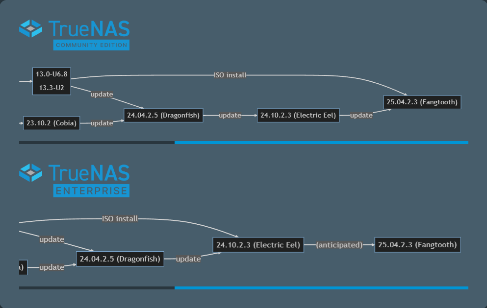

I have my old TrueNAS/FreeNAS server running the latest community version of TrueNAS Core (13.3-U1.2). The initial install was FreeNAS 9.10.2-U5 that I have upgraded over time since. I saw that SCALE had reached parity with CORE, so I was thinking migrating to SCALE. What would be best upgrade path for me? My server acts as file server, Plex server and backup my main machine via SSH. Can go directly to 25.04/25.10 via the GUI?
No you should follow the recommended update path:
Is there a 13.3-U2 of CORE? I have 13.3-U1.2 installed would that matter for migrating?
no that shouldn’t matter, as long as you go to scale 24.04 first and then 24.10 and then to 25.04

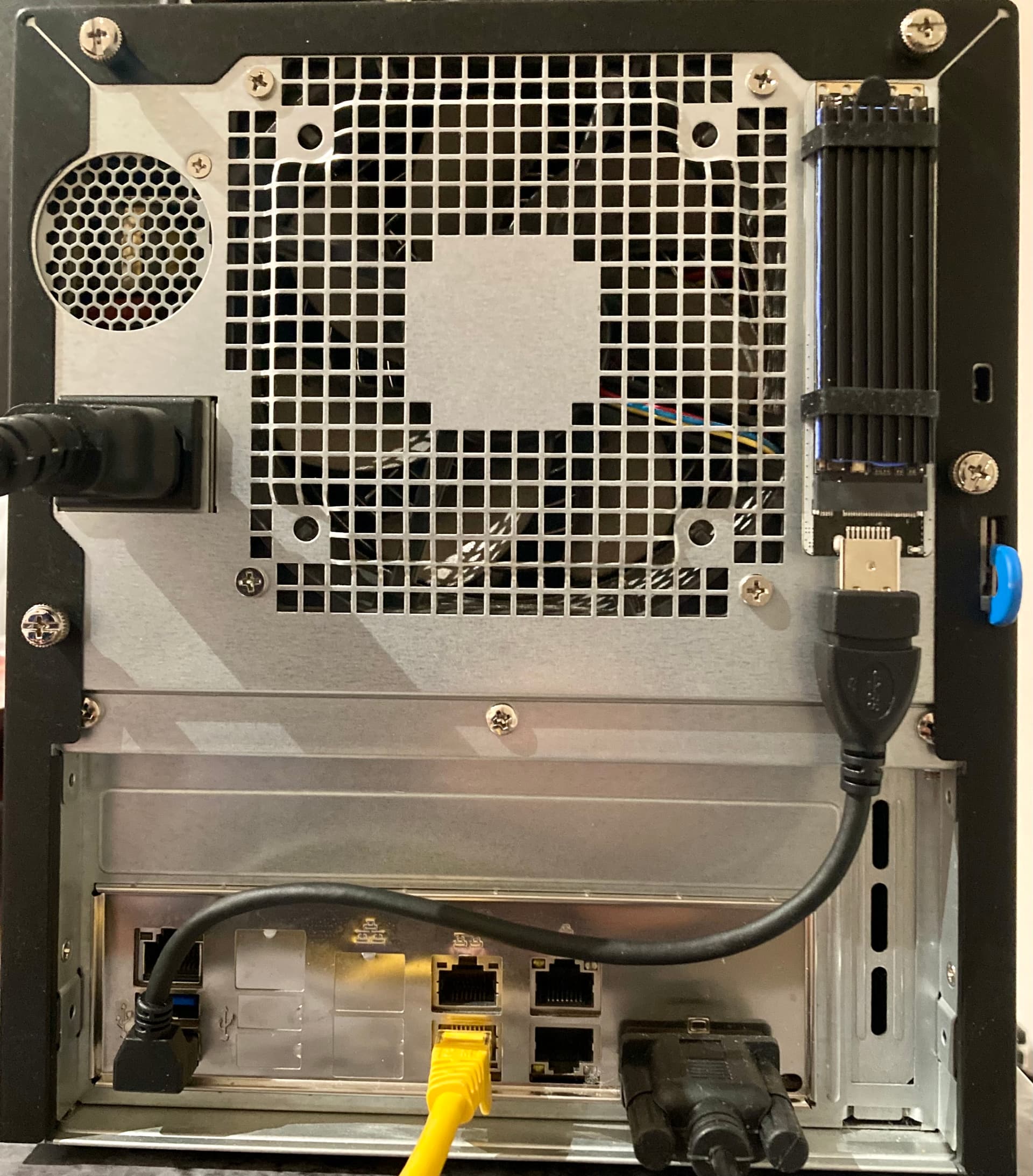

However, if your server is at home in a protected location, and you don’t want to lose a PCI lane then you can still arrange to boot from USB by getting a cheap M.2 SSD (for around 30 GBP) and putting it in an NVME-to-USB adapter (around 15 GBP). Attach this assembly to the back of your server case with a Command strip somewhere out of the way of fan exhaust, and connect to USB port with a short USB cable having a right-angle plug at one end.
This what I did, after suffering a thumb drive boot failure with Core 12. It has been working well for a year so far on Core 13 running 24/7.
