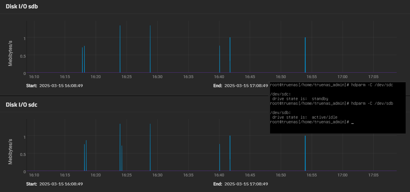

And one drive go to spindown mode like in 5 seconds after inactivity. How can i stop from immediate spindown?

im 100% sure i start happening now bc i monitor truenas server with smart plug. Drive normally slept after set period of time. Now it start ignoring it.

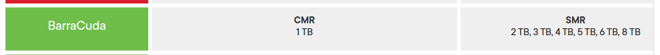

Are you sure? This is an old model, the product sheet I found was from 2017. But even new 3.5" 1TB Barracudas are still CMR.
A smart test might be in order, though. :slightly_smiling_face:
I have to apologize, I used a bad search engine, must have been ChatGPT. I looked it up the correct way this time. It is a CMR drive. I have to strike all that I previously said.
Screenshot 2025-03-15 200001
