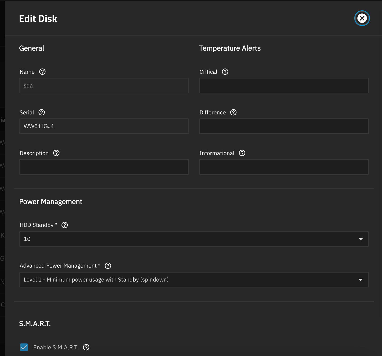

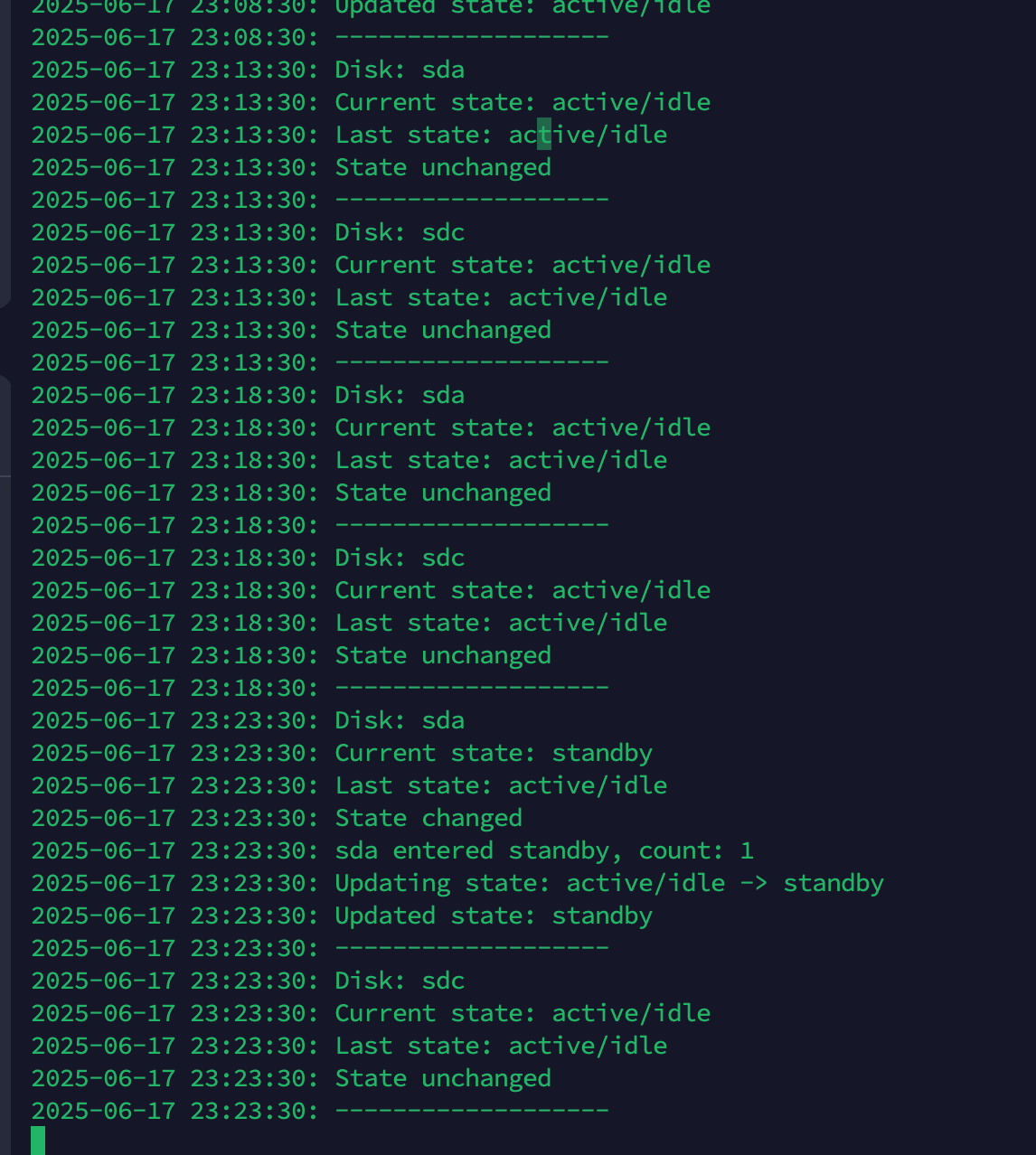

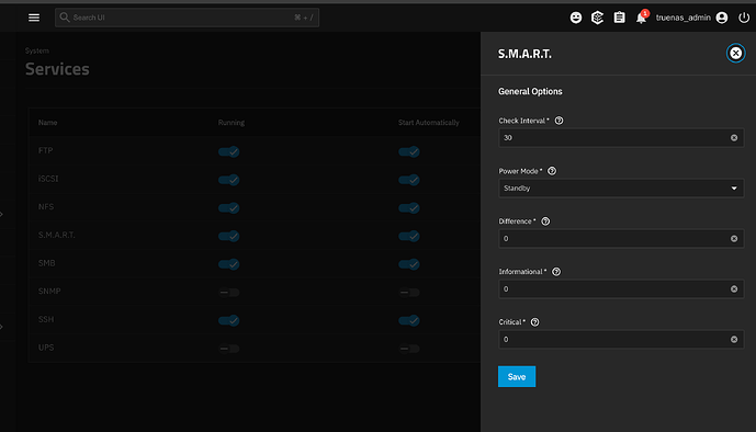

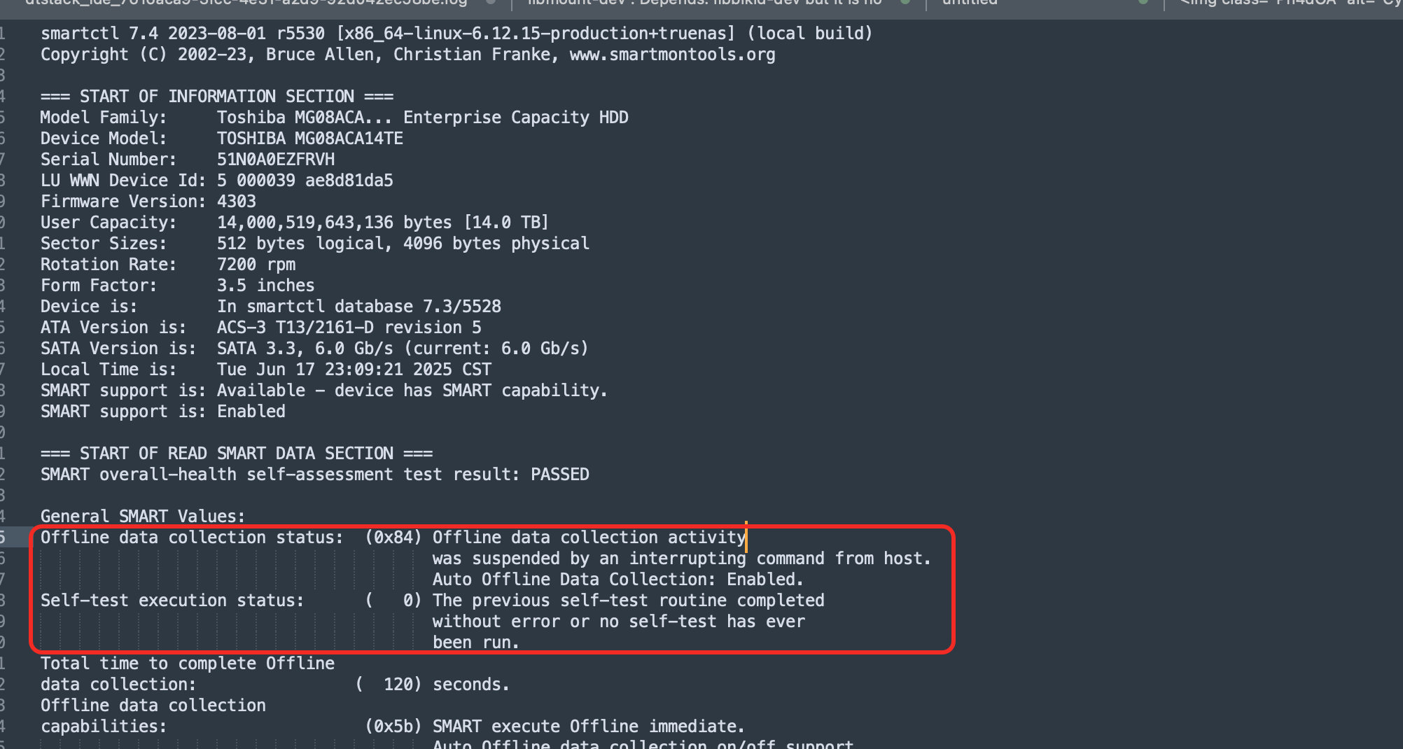

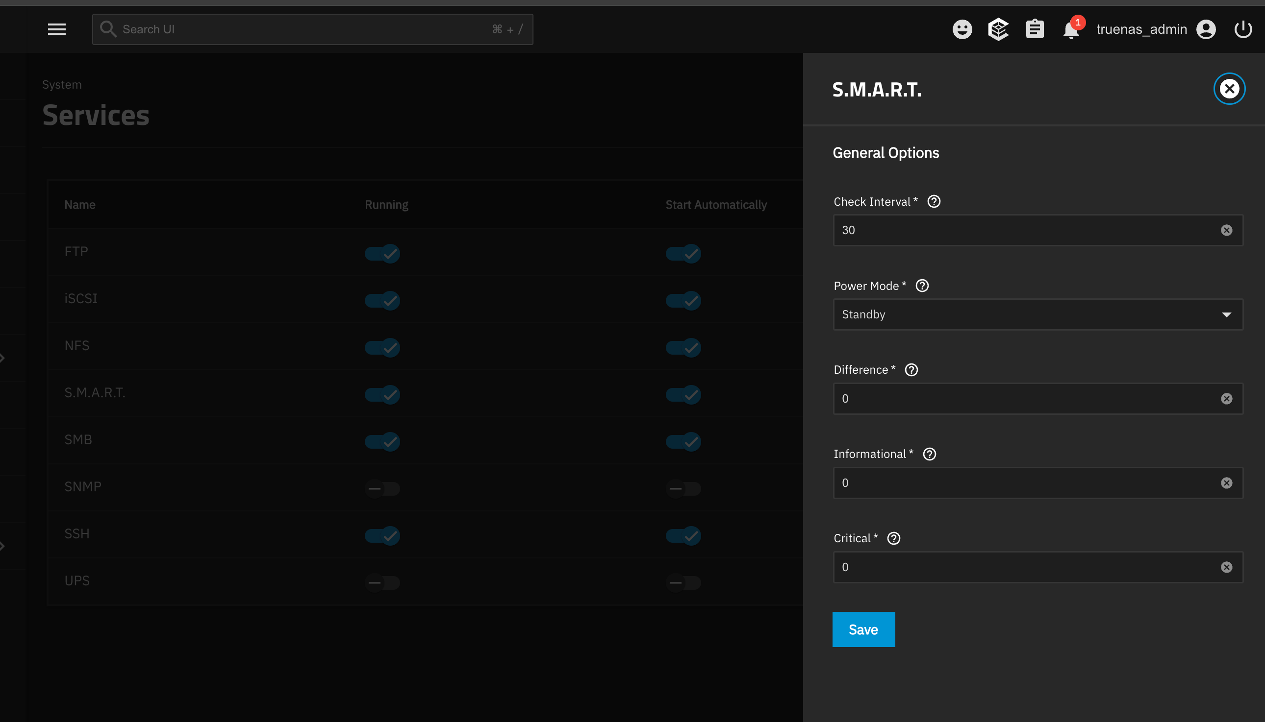

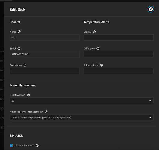

I have five hard disks installed on my truenas, four of which are ST4000VX016 and one is Toshiba MG08ACA. Before, if the five hard disks were not read or written for a period of time (I set it to 10 minutes), they could normally enter the standby state and hibernate. But since last Sunday, the Toshiba MG08ACA hard disk cannot enter the standby state and has been in the active/idle state, while the other four hard disks are still normal. I carefully checked the configuration of the five hard disks on the truenas, and I am sure that their configurations are the same. But I can manually put the Toshiba MG08ACA into the standby state by executing sudo smartctl -s on -s standby,300 /dev/sdX. But if the hard disk is woken up here, the Toshiba MG08ACA will not be able to enter the hibernation again after being idle unless I execute sudo smartctl -s on -s standby,300 /dev/sdX again. In short, the Toshiba MG08ACA hard drive can no longer automatically enter standby mode. I found some errors with the Toshiba MG08ACA through smartctl, and I’m not sure if these errors are the cause, so I hope someone with experience can give me some guidance. I will attach some of my screenshots below. /dev/sdc is the Toshiba MG08ACA hard drive, and /dev/sda is the ST4000VX016.

Truenas started the hard disk offline self-check on Sunday, but I restarted Truenas before the self-build was completed, so the offline self-check was interrupted, which can be seen from the smartctl-of-sdc.txt attachment. I am not sure if this is the reason why the hard disk cannot sleep, but I am sure it is the only operation I have.

After some attempts, I found that the reason why the Toshiba MG08ACA does not automatically enter standby is that Auto Offline Data Collection is enabled. Does anyone know why enabling Auto Offline Data Collection will cause the Toshiba MG08ACA to not automatically enter standby?
Seeing this question on Serverfault, tldr: it’s vendor-specific. It looks like your drive does offline tests and it obviously requires the discs to be spinning, disabling standby features.
