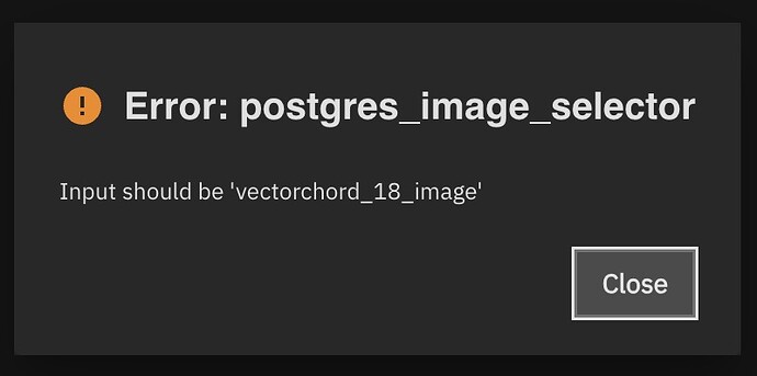

Immich App Update to 2.6.0 fails with Postress Error
When trying to update Immich to 2.6.0 it errors out with…
Any ideas what may be causing this? Its the first Immich update that has given me issues. I can restart the Immich again but it will not upgrade.
I’m on TrueNAS 25.10.2.1
Thanks!
Immich has been nothing but trouble when updating via community apps for me, haha. First I will say, take my advice with a grain of salt because I am a noob. Hopefully someone smarter comes along and gives better advice.
What you need to do is edit the app and change Postgres Image (CAUTION)* dropdown to Postgres 18 from Postgres 15. However this still caused problems for me because the database migration failed when I peaked at the logs. I tried rolling back via a snapshot and tried again to no luck. So I ended up just deleting my pgData folder and recreated it. I have no idea if that is a good or bad thing to do, but my photos are stored via a host path vs the integrated ix-volumes. So the way I look at it: as long as my host path isn’t getting deleted I don’t really care. Keep in mind though you will have to reset up Immich when deleting the Postgres folder because that’s where Immich keeps all of it’s information.

When you edit the app there should be a drop-down menu where you can choose the postgres version. Choose 15 or 18, redeploy the app and it should auto migrate
Postgres 15 has been deprecated but a “bug” allowed to upgrade to later versions without forcing the user to upgrade Postgres first. So you will need to get Postgress Updated first. Have a look here for details: Immich pgvecto_upgrade fails when upgrading PostgreSQL from 15 to 18 with ERROR: Old PostgreSQL [15] binaries not found at [/usr/lib/postgresql/15/bin] · Issue #4628 · truenas/apps

I just had to deal with this myself.
I rolled back a version from the drop down (roll back) - scroll to the bottom to find your latest previous version. The advice from @DjP-iX pointed me in this direction. I think it was 1.13.4 (app version) for me.
Once I verified Immich works okay on the older version - upgraded postgress to 18 (many notes in the post and also the depreciation notice in the edit section)
Once Immich started - applied the upgrade - it completed okay.
Hope this helps somebody.
Thank you!
Here is a full summary of the solution that worked for me:
