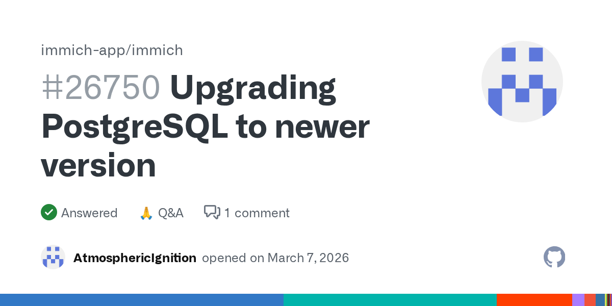

As for the possible fix i mentioned, i was referring to this specifically. I don’t know if it would actually work or not, but it was a lead
But the problem why i couldn’t do that, was because i use docker compose which has immich, posgres all loaded up in the same docker compose. so posgres would fail to start up… so… i could not run the commands with that possible fix.
asking ai, they mentioned u had to run that thing in a temporary space to get around a container not running due to error. that’s as far i got. Didn’t want to do stuff i’m not too certain about to avoid creating issues. hence why i am waiting ^^;
