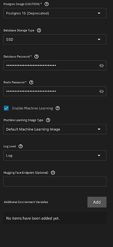

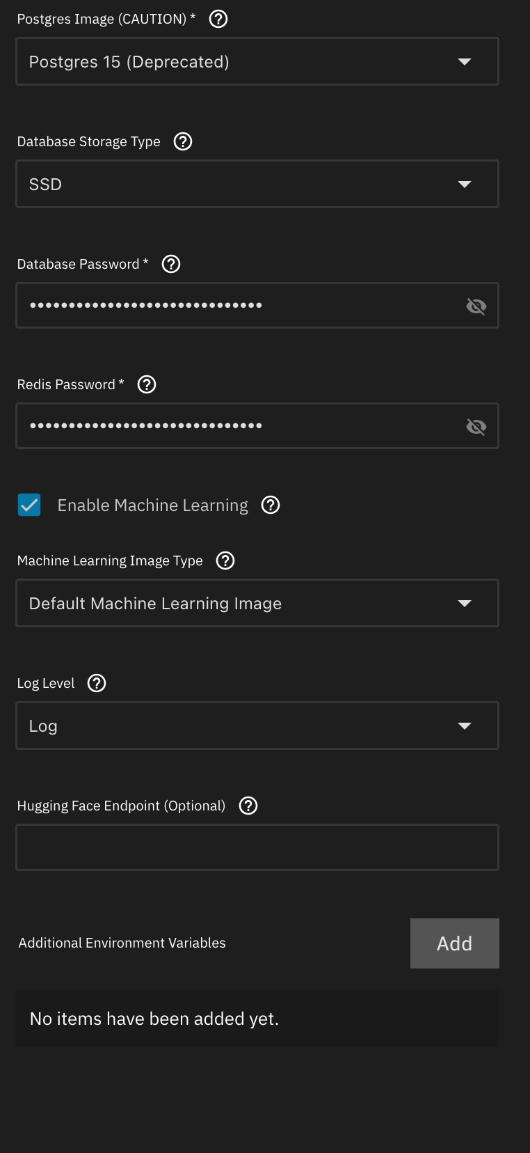

Immich gives [EFAULT] Failed ‘up’ action for ‘immich’ app, please check /var/log/app_lifecycle.log when updating to postgres 18
So I tried to upgrade the database from 15 to 18. But get: [EFAULT] Failed ‘up’ action for ‘immich’ app, please check /var/log/app_lifecycle.log.
Selecting the 15 still works.

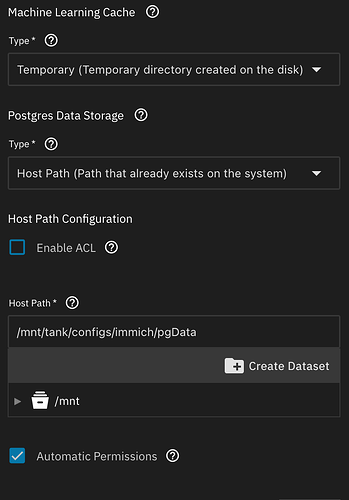

  1. changing ixsystems/postgres-upgrade tag to 1.1.11 in the /mnt/.ix-apps/app_configs/immich/versions/1.13.6/ix_values.yaml
  2. changing the chown to 999:999 and chmod to 700 on the pgData with -R and checked that in truenas automatic permissions are set
working configuration:
cat /var/log/app_lifecycle.log app_lifecycle.log - Pastebin.com
docker logs ix-immich-pgvecto_upgrade-1 docker logs - Pastebin.com
