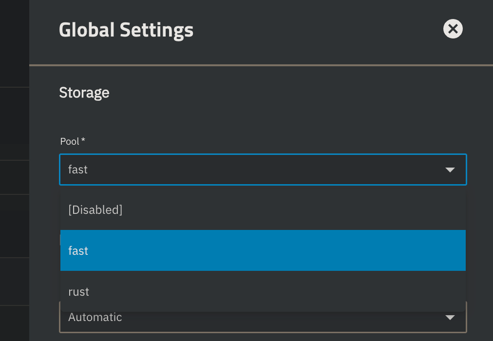

the issue was the pool was already selected (i was reverting to a boot image that had incus setup but no instances)

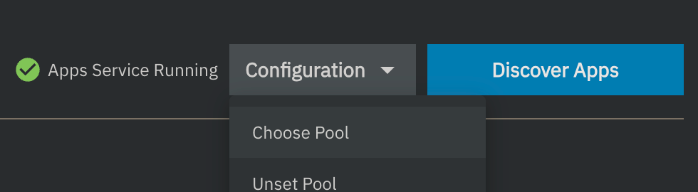

the issue is the UI doesn’t let me deslect the pool and reselect (like apps does)
ahh i see my confusion, i never looked in the global settings to disable and re-enable, becuase i was expecting this
vs
suggestion - maybe some ui consitency, if choosing a pool is done there in apps, the same should be true in incus… (or vice versa) - different design patterns for the same type of thing always make stupid users like me stupider.
Some UI elements related to this are being updated in 25.04.1.
