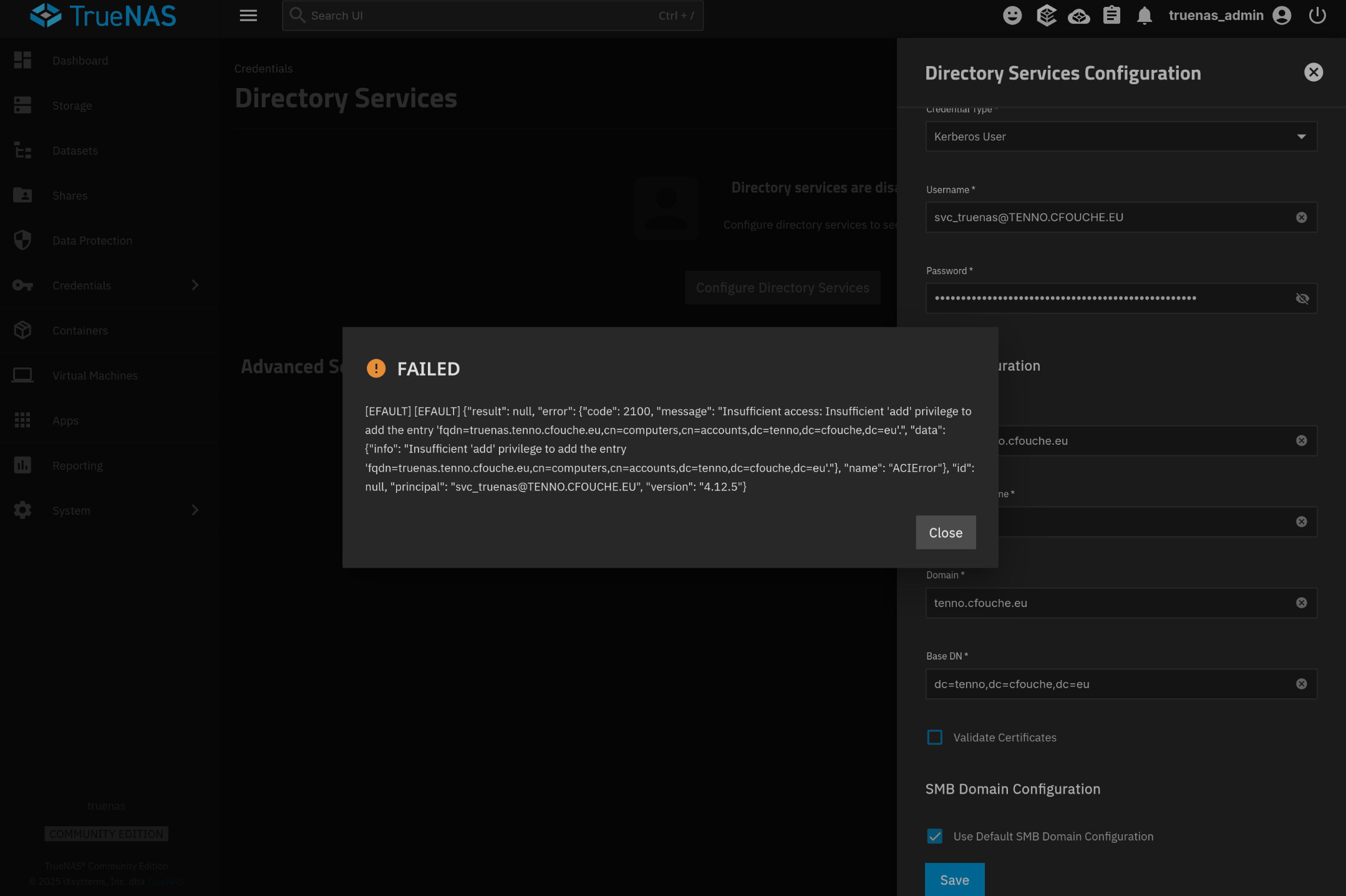

I tried to setup an active directory join on a fresh install of truenas 25.10 and I was hit by this error :
Seeing that not working (the domain was working, I could join others machines and synology nas) and seeing that IPA was supported, I decided to try. Same error :

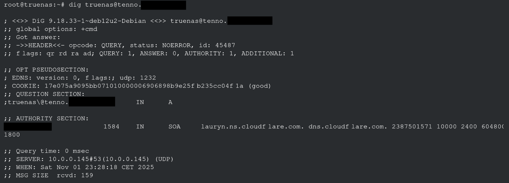

I found that to check if the nameserver are correct and if the hostname is already used, truenas call hostname@domain

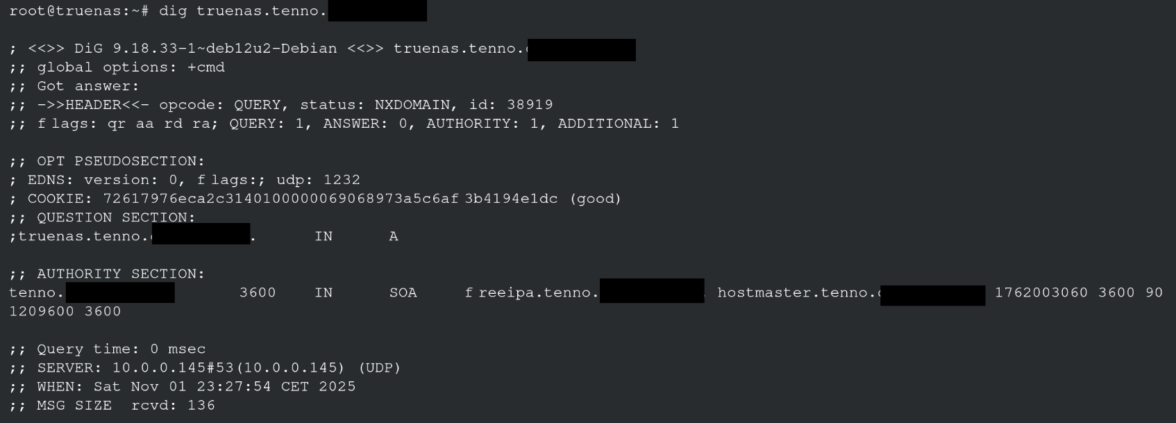

After digging further, this is why I can add my freeIPA domain to Truenas.
TrueNAS validate_dns function only work if it receive an NXDOMAIN but by sending hostname@my.domain, it receive an NOERROR with empty A record

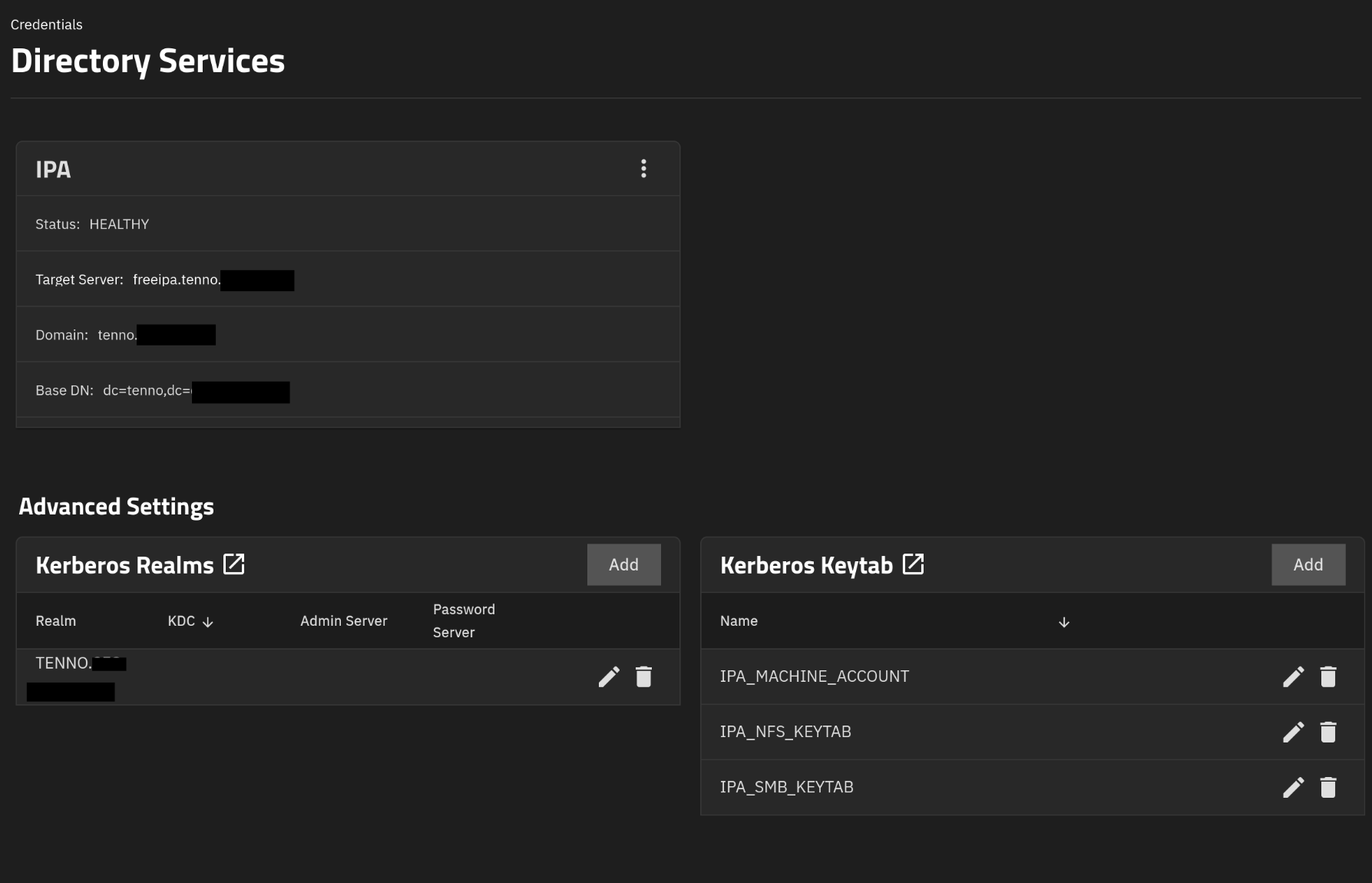

And after building a patched truenas build of 25.10 (thanks truenas team to make this process very simple and accessible), I can pass the validate_dns check (the patch is just replacing the @ with a dot) and connect to FreeIPA :
(I know it’s failed but it’s normal, I was test with a not privileged user)

Join successful with FreeIPA (should also work with Active Directory)
