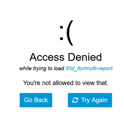

To note that the link given by Constantin does not work for me, I get an access denied.

If I click, I get:
If I copy the link, it gives me:
And if I enter this manually on a new tab, it goes to a page that says:
The real link seems to be:

I just amended the link also, I thought the number at the end referred to a post number or whatever, so I removed it. It should work now.
It does.
Even when not working, it steered me in the right direction anyway!
