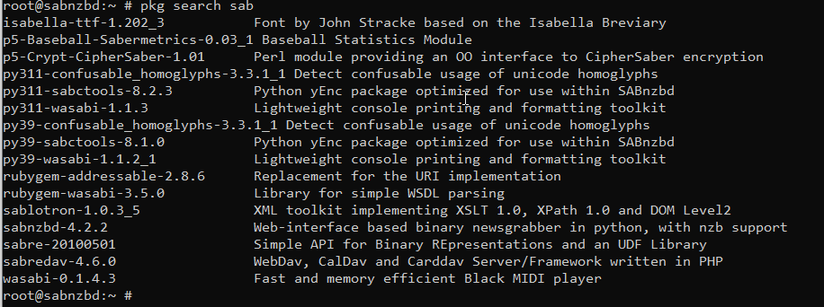

I’m running Core 13.0-U6.1 and currently have Sabnzbd package version 4.2.2. I am trying a new install of version 4.3.2. I know there is no package or port for that version yet, so I’m trying to install from source, both to get the new version and as a teaching experience. As an aside, it looks like the 4.2.2 package is no longer available. In fact, there are no sabnzbd packages at all available from what I can see.
