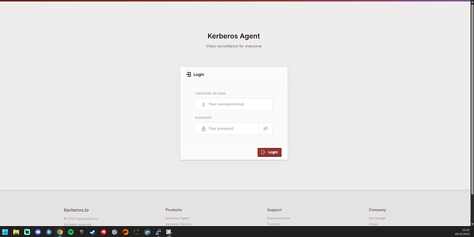

Ok i tried and got it working with the following steps:
  1. Create a Dataset on your storage pool for persitent app storage (preferably on an ssd pool) with the apps preset. I created a dataset called “test” for you i’d propably call it kerberos-io-agent or something similar to your liking.
  2. I used the yaml i provided in my first post, adjusted the storage path so that it points to the dataset i created in step one
    In the yaml you should replace the /poolname/datasetname with the actual path on your Pool.
  3. use an ssh session and navigate to the config folder on your pool. Inside the config folder you have to manually create the config file with
sudo touch config.json
and then edit the config file with
sudo nano config.json
copy the content of this link
https://raw.githubusercontent.com/kerberos-io/agent/master/machinery/data/config/config.json
into the config.json and save it.
  1. In the truenas webui go to the apps section and click on the big blue button Discover Apps in the top right corner. Again in the top right corner of the screen click on the three dots next to the big blug “custom app” button. Select “Install via yaml”. copy the yaml below into the window, Edit the storage paths to the ones you’ve created in step 1 hit save and it should start
services:
  kerberos-agent1:
    image: kerberos/agent:latest
    ports:
      - '8082:80'
    environment:
      - AGENT_NAME=agent1
      - AGENT_CAPTURE_IPCAMERA_RTSP=rtsp://x.x.x.x:554/Streaming/Channels/101
      - AGENT_HUB_KEY=yyy
      - AGENT_HUB_PRIVATE_KEY=yyy
    volumes:
      - /mnt/Plugins/test/agent1/config:/data/config  #change /mnt/Plugins/test to the path on your pool!!!!!
      - /mnt/Plugins/test/agent1/recordings:/data/recordings
x-portals:
  - host: 0.0.0.0 #change 0.0.0.0 to your truenas's ip
    path: /
    port: 8082
    scheme: http
I don’t have cameras to test so i don’t know what have to be set for the env variables…

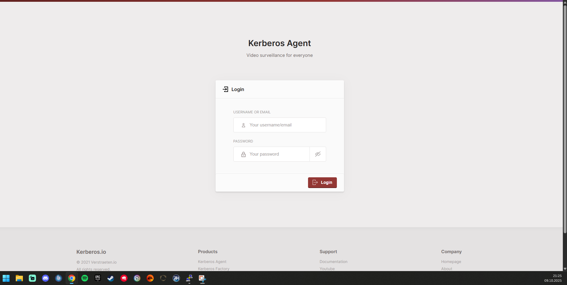

With the steps above i was able to launch it successfully
If you need more agents create separate apps for each one and change the port from 8082 to 8083 and so on (don’t forget the webportal port)
Each agent needs a unique port number.
