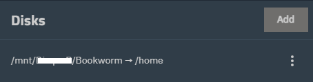

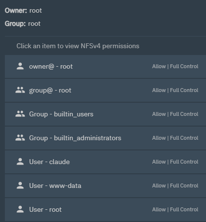

I created a container instance on the pool “pool1”.
I defined a disk on a “Bookworm” dataset from an external pool “pool2” (/mnt/pool2/Bookworm). This dataset is mapped to the “/home” directory.
When I try to access “/home” (cd /home), I get the error :
“Bookworm” permissions :
It’s an idmapped mount. Root is not an idmapped account.
Thanks for your reply.
I’m not familiar with idmapped mounts. I’ll look into that.
Look at the OP, Step 7
