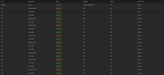

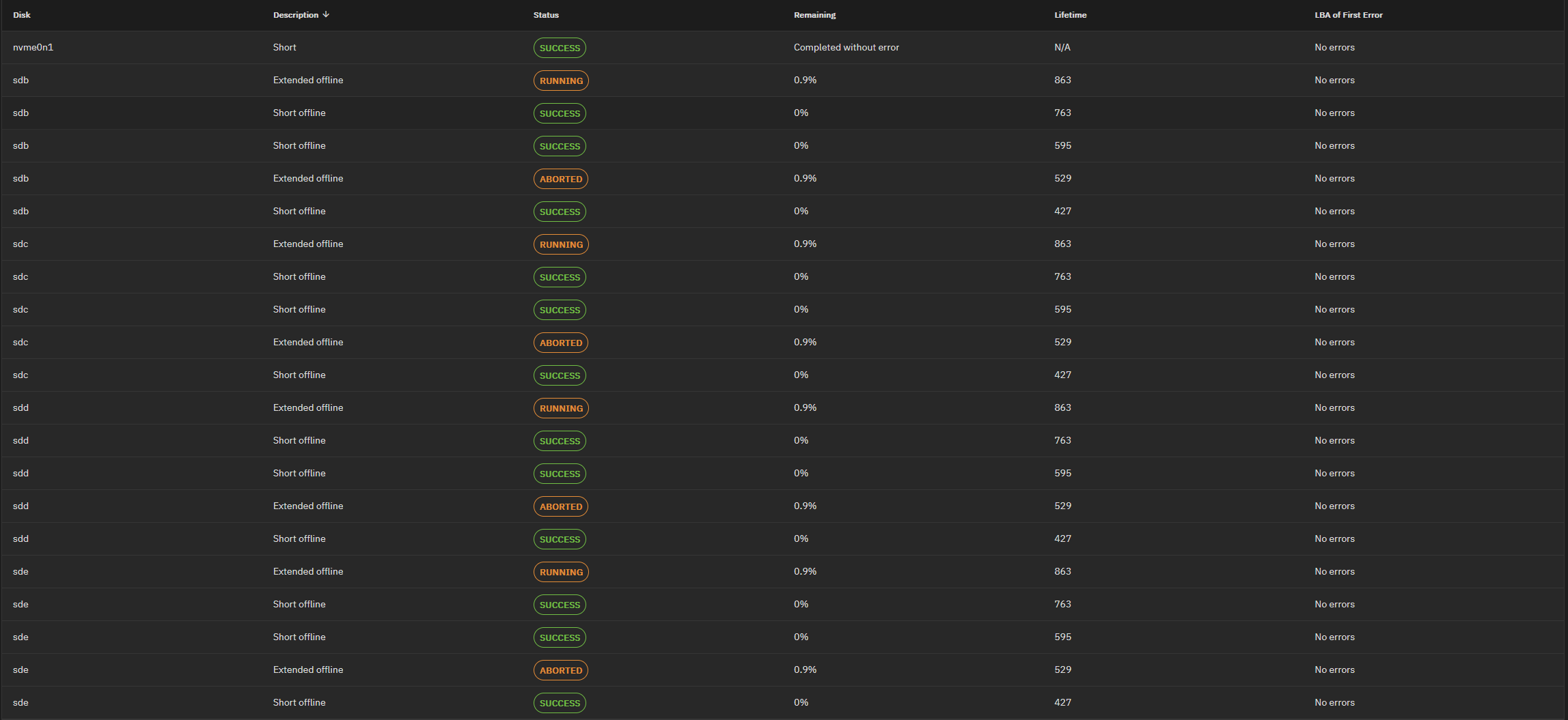

I’ve had a problem with long S.M.A.R.T tests ever since I switched from CORE to SCALE. No matter how long I wait, the test always hangs at 0.9% remaining even though there is no running job in the jobs page. I don’t know how to tell whether it’s a GUI bug or if it’s actually stuck, but that does not happen with short tests. I am using ElectricEel-24.10.0.2 and TrueNAS is virtualized on Proxmox, with the whole SATA controller passed-through. Here’s what I have in the GUI:
This is the output of
smartctl -a /dev/sdb

SCT Error Recovery Control:
Read: 70 (7.0 seconds)
Write: 70 (7.0 seconds)
Device Statistics (GP Log 0x04)
Page Offset Size Value Flags Description
0x01 ===== = = === == General Statistics (rev 1) ==
0x01 0x008 4 35 --- Lifetime Power-On Resets
0x01 0x010 4 863 --- Power-on Hours
0x01 0x018 6 56037383536 --- Logical Sectors Written
0x01 0x020 6 97546095 --- Number of Write Commands
0x01 0x028 6 75509903087 --- Logical Sectors Read
0x01 0x030 6 630911626 --- Number of Read Commands
0x01 0x038 6 - --- Date and Time TimeStamp
0x03 ===== = = === == Rotating Media Statistics (rev 1) ==
0x03 0x008 4 856 --- Spindle Motor Power-on Hours
0x03 0x010 4 850 --- Head Flying Hours
0x03 0x018 4 145 --- Head Load Events
0x03 0x020 4 0 --- Number of Reallocated Logical Sectors
0x03 0x028 4 0 --- Read Recovery Attempts
0x03 0x030 4 0 --- Number of Mechanical Start Failures
0x03 0x038 4 0 --- Number of Realloc. Candidate Logical Sectors
0x03 0x040 4 24 --- Number of High Priority Unload Events
0x04 ===== = = === == General Errors Statistics (rev 1) ==
0x04 0x008 4 0 --- Number of Reported Uncorrectable Errors
0x04 0x010 4 0 --- Resets Between Cmd Acceptance and Completion
0x04 0x018 4 0 -D- Physical Element Status Changed
0x05 ===== = = === == Temperature Statistics (rev 1) ==
0x05 0x008 1 47 --- Current Temperature
0x05 0x010 1 49 --- Average Short Term Temperature
0x05 0x018 1 - --- Average Long Term Temperature
0x05 0x020 1 59 --- Highest Temperature
0x05 0x028 1 20 --- Lowest Temperature
0x05 0x030 1 54 --- Highest Average Short Term Temperature
0x05 0x038 1 41 --- Lowest Average Short Term Temperature
0x05 0x040 1 - --- Highest Average Long Term Temperature
0x05 0x048 1 - --- Lowest Average Long Term Temperature
0x05 0x050 4 0 --- Time in Over-Temperature
0x05 0x058 1 60 --- Specified Maximum Operating Temperature
0x05 0x060 4 0 --- Time in Under-Temperature
0x05 0x068 1 5 --- Specified Minimum Operating Temperature
0x06 ===== = = === == Transport Statistics (rev 1) ==
0x06 0x008 4 67 --- Number of Hardware Resets
0x06 0x010 4 21 --- Number of ASR Events
0x06 0x018 4 0 --- Number of Interface CRC Errors
0xff ===== = = === == Vendor Specific Statistics (rev 1) ==
0xff 0x008 7 0 --- Vendor Specific
0xff 0x010 7 0 --- Vendor Specific
0xff 0x018 7 0 --- Vendor Specific
|||_ C monitored condition met
||__ D supports DSN
|___ N normalized value
Pending Defects log (GP Log 0x0c)
No Defects Logged
SATA Phy Event Counters (GP Log 0x11)
ID Size Value Description
0x000a 2 4 Device-to-host register FISes sent due to a COMRESET
0x0001 2 0 Command failed due to ICRC error
0x0003 2 0 R_ERR response for device-to-host data FIS
0x0004 2 0 R_ERR response for host-to-device data FIS
0x0006 2 0 R_ERR response for device-to-host non-data FIS
0x0007 2 0 R_ERR response for host-to-device non-data FIS
Any help to figure out the problem is appreciated, thank you.
