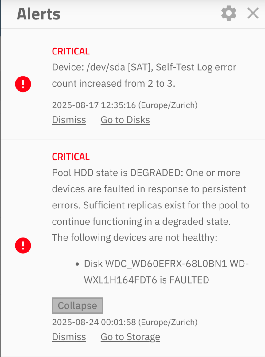

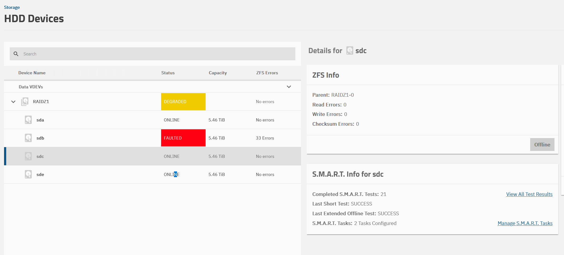

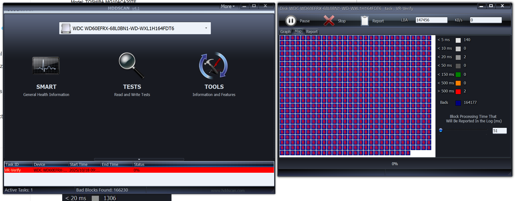

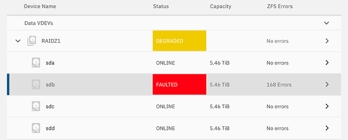

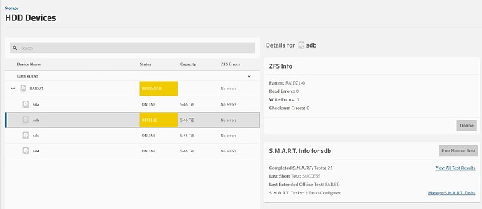

I’m Running 25.04.2.1 with 4x6tb Raid-Z1. Had issues a few weeks ago and once again got greeted by this error message.

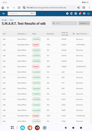

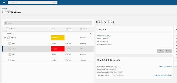

But as you can see by the drive Storage tab the faulty drive is not actually sda but sdb instead. Device 68L0BN1 as correctly named in the 2nd notification.
That’s a bug right?

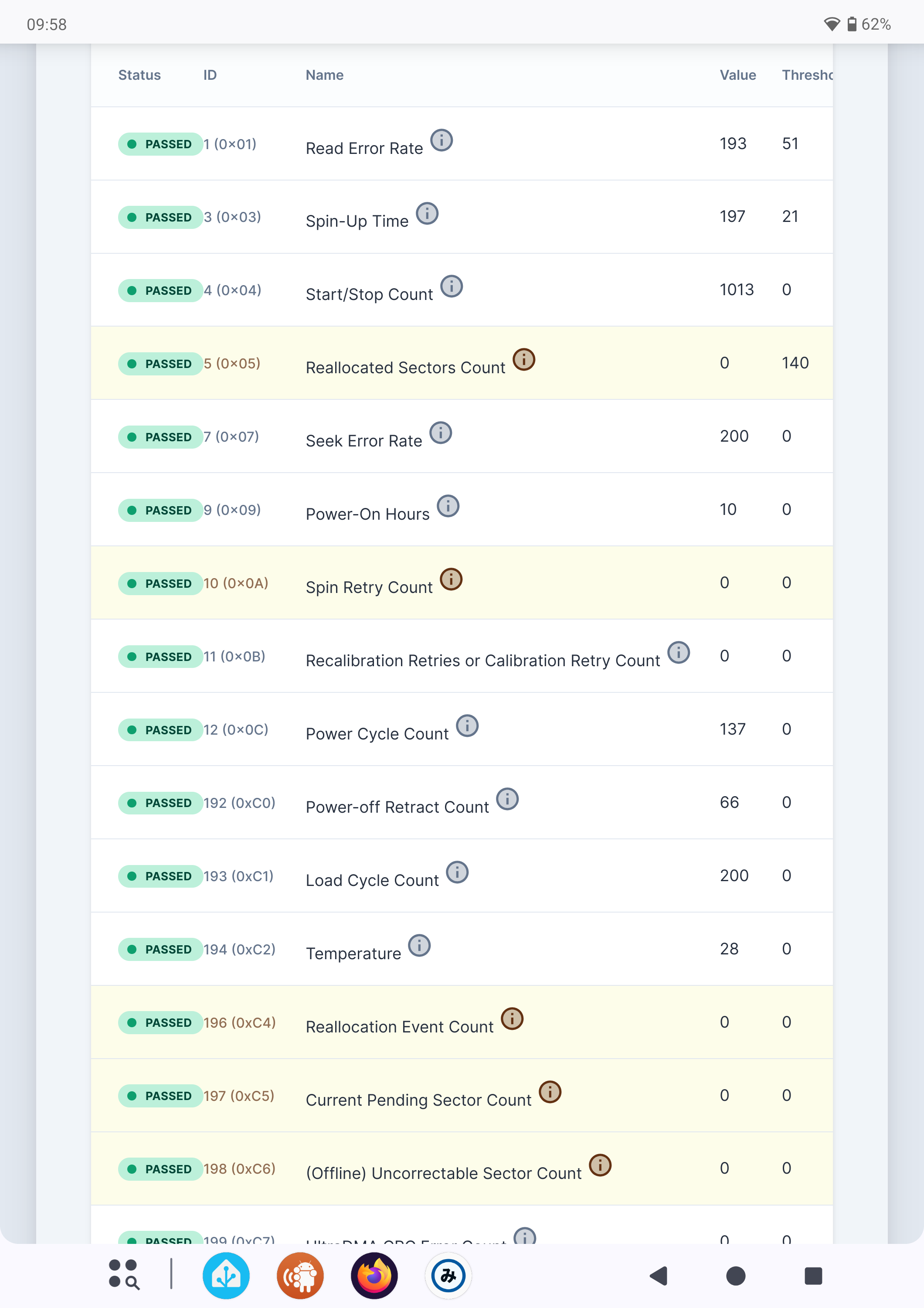

Also if you look at the Smart tests for sdb you can see the “power on hours ago” just jumping up to 65’000
Few days ago I installed scrutinity because you can’t read the smart values from the web interface.
Sadly the export function doesn’t work yet.
But same as the last one shown in the devices tab there are no errors.
The two error messages are not nessesarily related.

You have a WD drive and normally you will not have high Read Rate or Seek Rate numbers for a WD drive.
The Power On Hours has rolled over, this happens to many drives, but not all drives, and this can be confusing.
If you rebooted the system, drives sda and sdb can change positions, this is why we need all this data. At face value, the two error messages are not related, however we need more data to be certain.
Right… i heard about that before. You think that’s what happend here? Seeing as those 2 messages are 7 days appart, and i did upgrade BMC Firmware during that time so a reboot was involved, that does sound legit.

About the Hardware:
AMD Ryzen 5600 on a Gigabyte MC12LE0 Mainboard, all Sata Drives are connected to the Mainboard as it has 6 Ports.
admin@NAS[~]$ sudo zpool status HDD
  pool: HDD
 state: DEGRADED

            de0f3b0f-36aa-4754-a883-f806565c35a2  FAULTED    168     0     0  too many errors
errors: No known data errors

One of your drives has failed. This needs to be replaced as you currently have no parity
Another one of your drives seems too hot to me (45)

I see the pool stated degraded and the device faulted.
But no Smart values or any other indicators that the device is fully broken and parity doesn’t work at the moment. Which specific values indicates this?

This is the failed drive - its failing an extended test which means that at the very least you need to remove it from the pool, run badblocks on it and then consider if its potentially useable

So… i just assume the device is offline because it’s in Faulted state?
The only difference to another HDD is the “online” button there.
If press the “Offline” button again nothing happens.

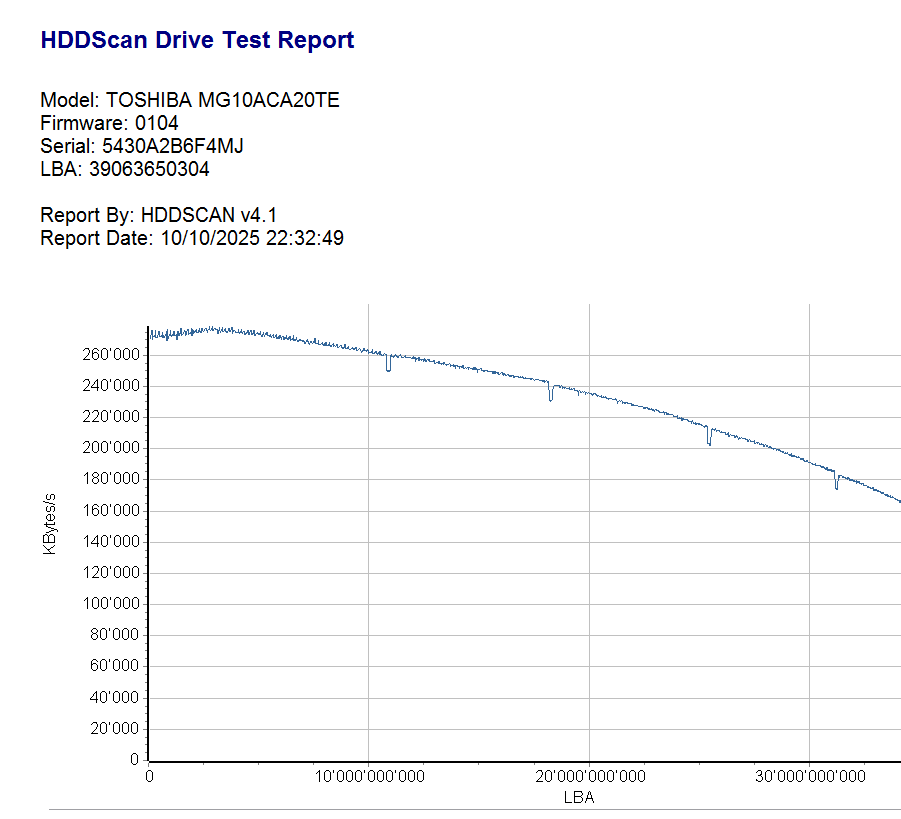

had the chance to get a 20tb Toshiba MG10
for 220 CHF used. Waranty until 2029
Did a quick ched but everything seems to be okay.
i see it takes quite a while for a device to actually become “offline”

After the thoshiba fully tested and seems to work fine I’ve replaced the drive.

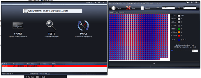

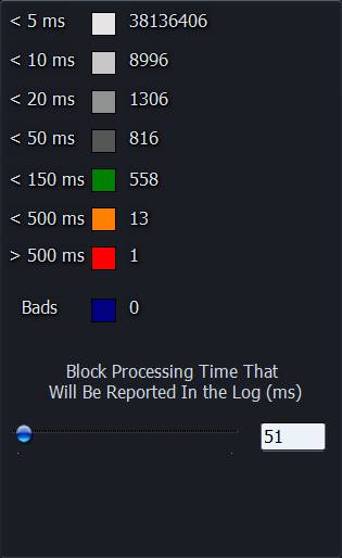

Now I can wipe and troughly these the 6TB WD Red.
I agree with drive failure as 1/4 of those drives already failed and had to be replaced by a Seagate 5 years ago!
Yeah… i think the WD Drive might be gone…
