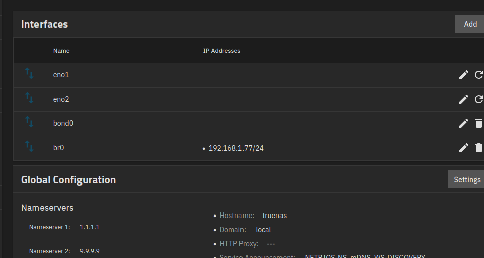

I am having an issue on 25.04.1 setting up a bridge on a bond.
My system is a truenas mini-xl
The interfaces are eno0 and eno1

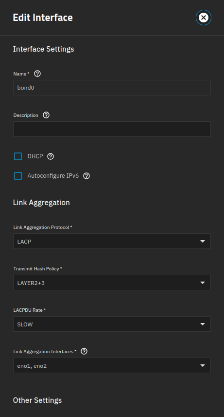

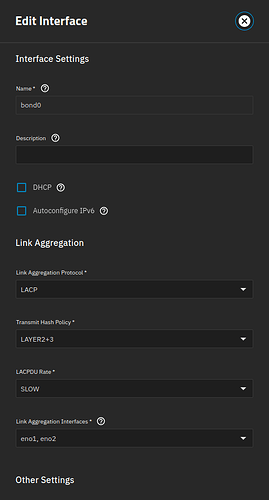

I have successsfully setup the bond0
everytime i try to setup the bridge, I lose acces to the UI
Any thoughts? Happy to share more info

No onto the issue, I navigate to networ configuration

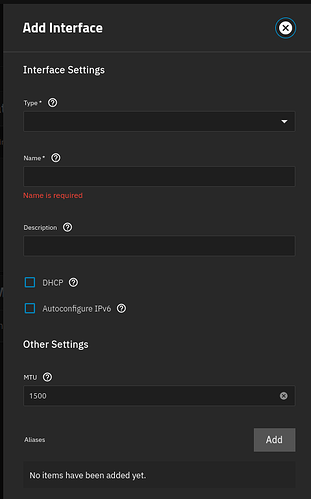

Goto add an interface

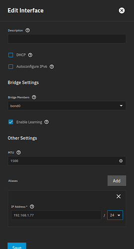

Populate the type, name and members
Then Save the config

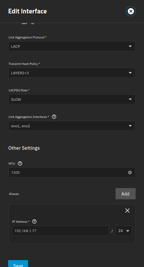

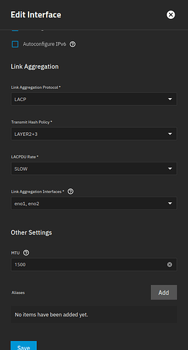

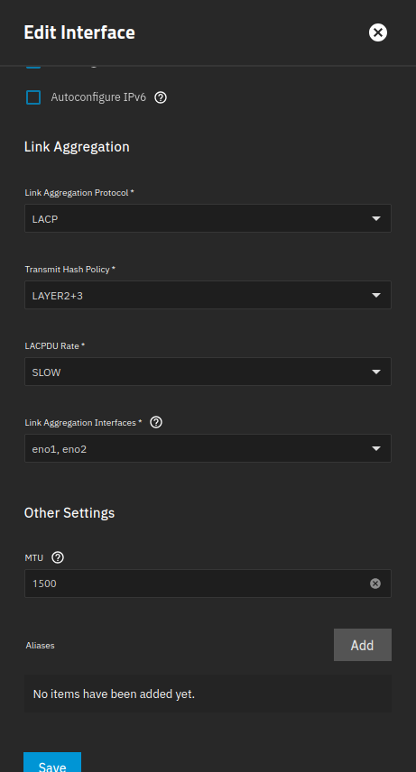

After this I go into the bond0 interfance and remove the alias
And then put the alias in the bridge

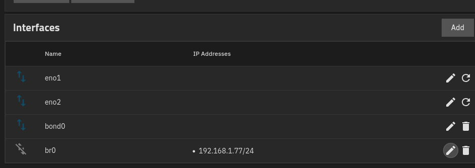

After this I test the config, which returns in about a 1s or 2s
Then I save the config
Shortly after saving, I loose access to the UI.

  • add an alias to the bond0
