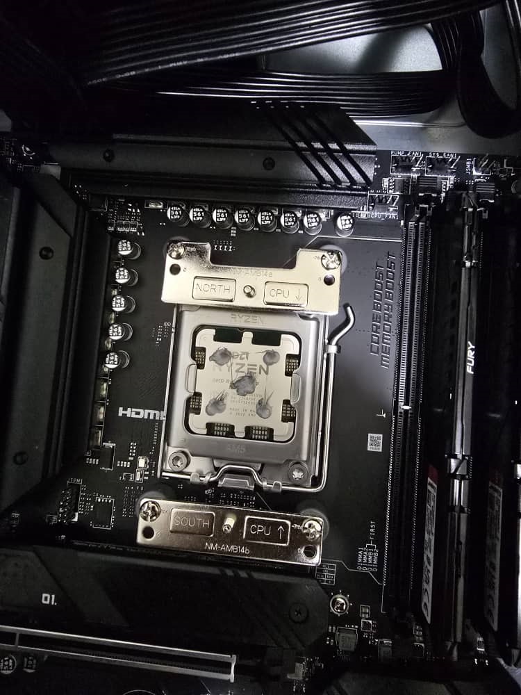

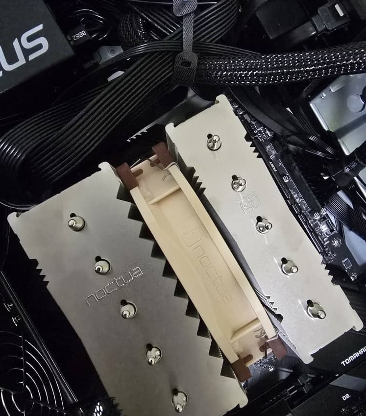

*update
installing cpu cooler wish me luck
will take a while. worried i make mistake. maybe pic tomorrow :grimacing:

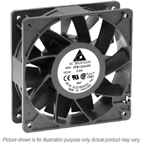

That’s for preventing wires from getting tangled in the fan, not fingers.
The CPU area is visibly no issue. It’s all about the HDD cage, and whether you prefer to pull air from the drives or push air to them.
IDK, my extra computer fans turn into random hobby fans and I keep a baggie of some spare grills in my box of cooling supplies xD
They have saved my fingers.
It trades depth for height.

i followed instructions. youtube said spread it out, but noctua said 5 dots is sufficient (and that if u put too much it negatively impacts). so i went with noctua’s advice.
i checked the fan is in the correct direction.
the height fits. no issue there but it’s cutting it close.
was checking if there was any thin plastic film on the cooler, there was none. only the single big noticeable plastic cover

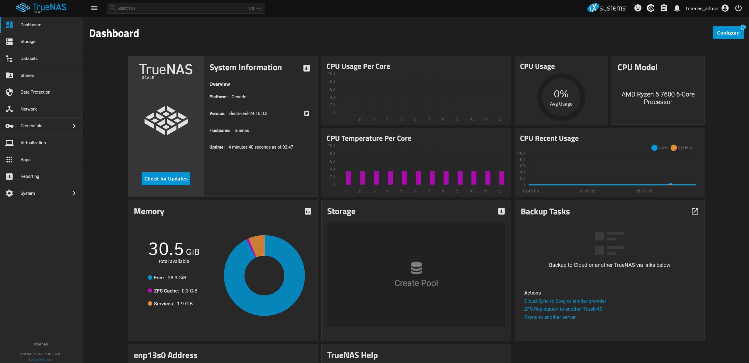

mobo booted up but not updated… doing that now. i did follow all the instructions… at least i did not brick my mobo :grimacing:
i also tried testing install truenas, but it goes to grub recovery… have to google why it doesnt boot to truenas properly for the setup :sweat:
*update
  • updated bios
  • configured bios (fans i set to smart. see how good that works. so far so good)
  • truenas usb installer didnt work. but i think i know what to do. testing (DD)
*update
as i suspected. for rufus use DD mode. the other doesnt work, no idea why.
The other thing is to disable secure boot. Apparently truenas does not support secure boot for some reason. Did a google, there was discussion about possible support in 2025? no idea.
successfully installed and using truenas
Now it’s just a matter of adding the other hdds, and doing the normal setup, nothing much interesting.
Only thing i can add later is the temps after some extended use. But so far so good.

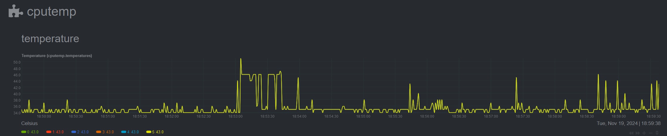

cpu temps
average: 34c -45c
max: 60c

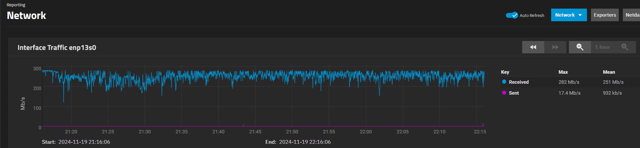

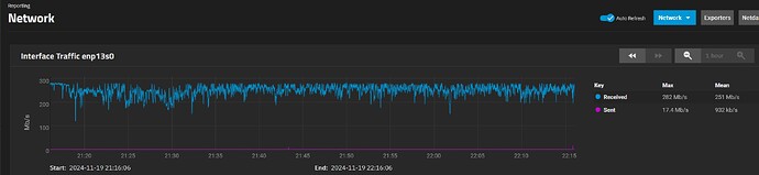

only downside is i don’t have an eta or progression of how much it transferred. i only know how fast it’s transferring
This is how fast it’s transferring :face_with_monocle:
ssd and hdd temps about 40c so all good.
Those network graphs show Mbps, not MB. Is the graph incorrect?

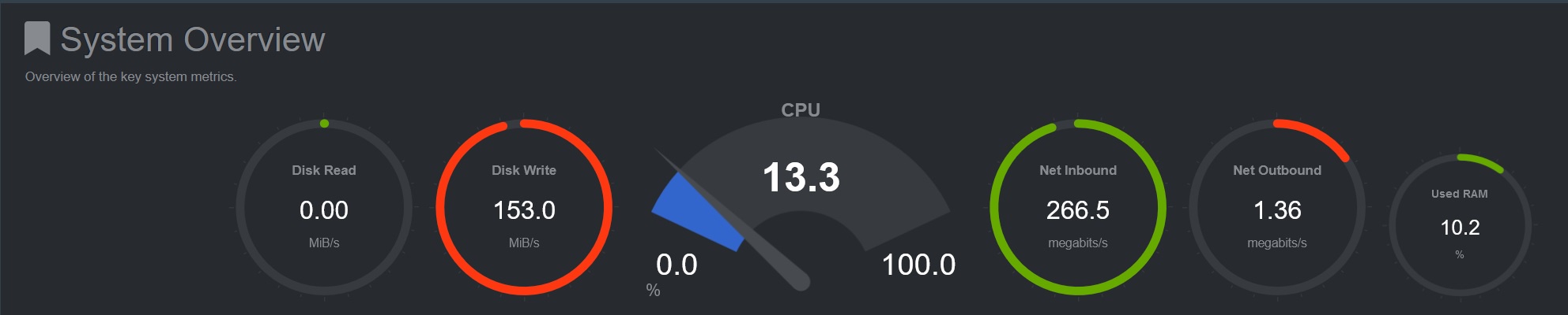

i checked again, in netdata is shows this
:thinking: i had rsync compression on, should that be disabled?
That GUI makes 0 sense to me; 153Mibs should be about 1283mbps…not 266mbps.
Either rsync is the most possible effective way of transferring data I’ve ever just now seen or something in the GUI ain’t syncing with what I understand about data transfer.
i was using this settings in rsync
only setting i wasnt sure mostly was delay updates and compress :sweat:
Never used rsync & am guessing you didn’t do anything wrong. The GUI just looks to be presenting incorrect data unless I’m really misunderstanding something…
