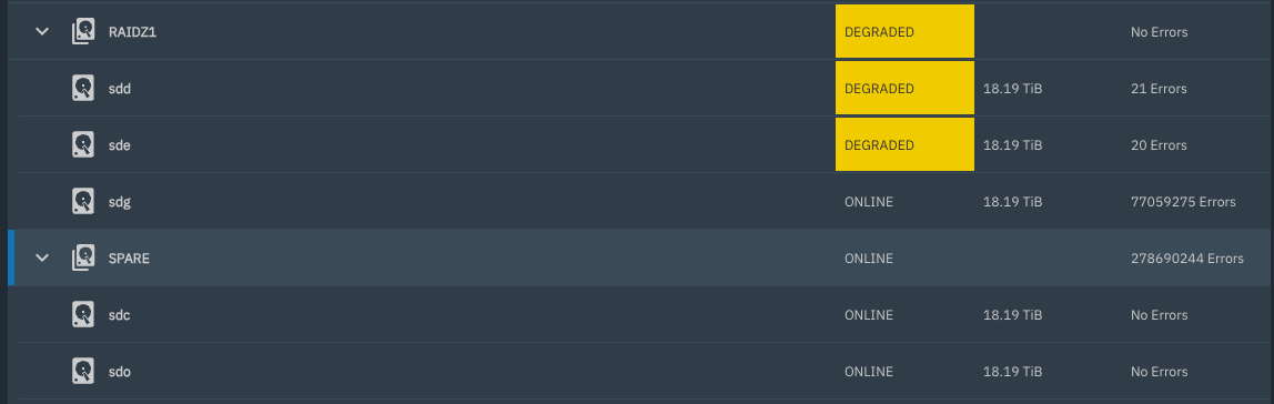

hey everyone, I’m new to truenas, and recently I had a drive failure. i had a hot spare in the system and after a resilver my VDEV layout looks really weird and is still in a state of Degraded. I’m not really sure how to get this back to normal or how much data I’ve lost. any help would be great. I’ve attached some images of what my vdev looks like.

I’ve already gone through the resilvering process with a replacement drive. I’m more concerned with why there are 2 spare drives in the VDEV and its still in a degraded state?
