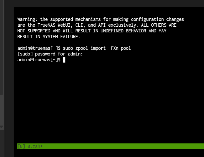

Tmux is a complicated beast, but we can keep it simple. Type tmux. Type sudo zpool import -FXn pool. If you evr get disconnected, type tmux attach to return to the unnamed session.
Снимок экрана 2025-06-08 121739
thats all.
am i doing smth wrong?

tried again. no output

i dont anderstant what kind of output must be afte dryrun.
No outpot after the completed dryrun is ideal.
But you really need to run it in tmux as has been mentioned a few times when it’s not a dryrun because your shell will almost certainly be closed before it finishes. Plus you appear to have severe power or networking issues that make connections especially unreliable.
The dry run return quickly with no error message? That means ZFS would be able to import. The “quick” part is puzzling, as we’d expect to wait quite some time while ZFS rewinds and checks at which point it can import.

root@truenas[/home/admin]# lsblk -o name,size,type,partuuid
NAME          SIZE TYPE  PARTUUID
sda         223.6G disk
├─sda1          1M part  0bfe2fd4-c7c6-48f7-95c3-9ac97455137b
├─sda2        512M part  c2e55895-c266-48e3-a249-8574d9502604
├─sda3      207.1G part  a8ca35d1-8aef-4b47-8784-68848999cfe0
└─sda4         16G part  ef366a6b-d331-4d0b-a08b-9c6e73abe626
sdb           3.6T disk
├─sdb1          2G part  9ee250cd-dccf-494c-aab3-1f2cc2fbd84c
│ └─md127       2G raid1
│   └─md127     2G crypt
└─sdb2        3.6T part  7148f5b2-5cf3-4f20-8f67-3e13d6350289
sdc           3.6T disk
├─sdc1          2G part  a4722b12-5b0f-476d-a704-7f384653ad21
│ └─md127       2G raid1
│   └─md127     2G crypt
└─sdc2        3.6T part  78768fa5-a92a-4548-9557-0f42401ccccf
sdd           3.6T disk
├─sdd1          2G part  9f7ed069-5e4e-4b7f-a806-5f9e40047067
│ └─md127       2G raid1
│   └─md127     2G crypt
└─sdd2        3.6T part  af598827-99d2-46cc-bb20-e3821e34ca31
sde           3.6T disk
├─sde1          2G part  02b02130-2f0b-415f-ae8c-85d849261c33
└─sde2        3.6T part  83c95c75-7fe2-4fec-9845-d974fc3f637f
