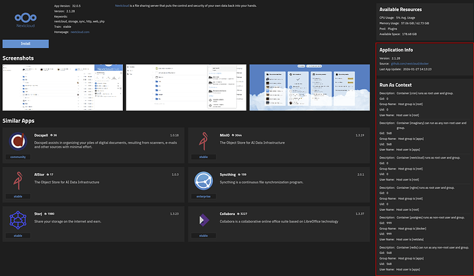

If you ever wonder whcih user need permissions for an app theres a “run as” context tile in the apps catalogue, that lists the permission the app runs as.

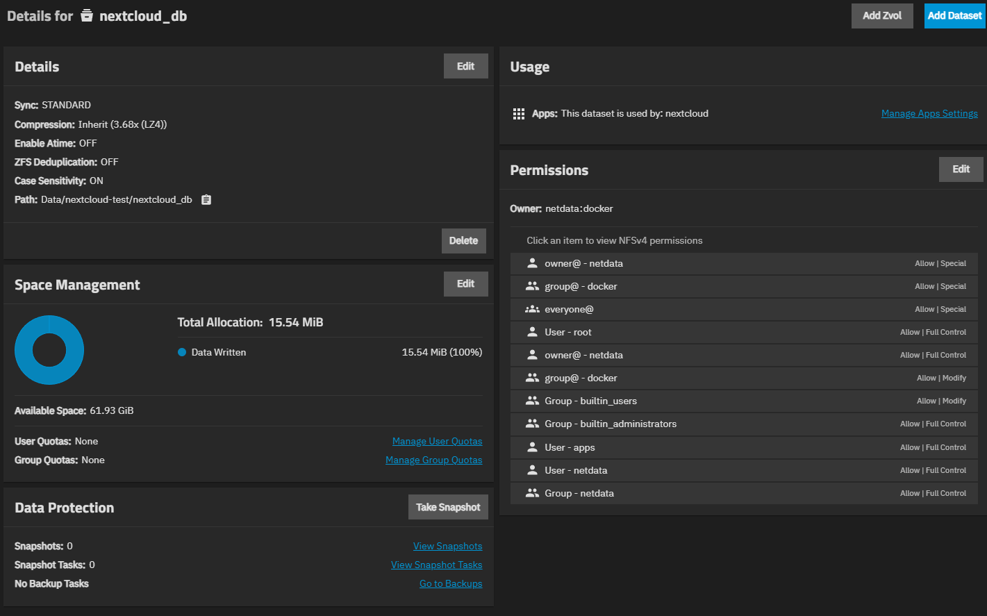

Ok i created a test installation of nextcloud. I created the dataset beforehand and added the permissions, but also got a permission error for the postgress db, eventhough i set permissions for user netdata. I then checked the “automatic permission” checkbox at the end of the storage setup section and it deployed and is up and running.
Edit: Here’s a screenshot of the Dataset permissions and fixed typos
