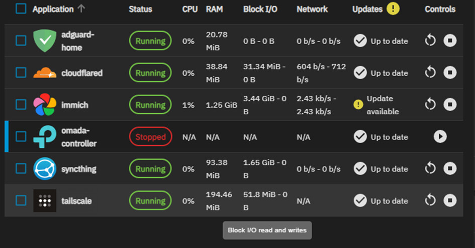

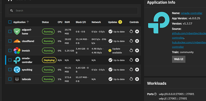

Hello, I am having trouble running omada-controller. After installation, the container does not start and does not generate any logs. It only says “deploying” and then “stopped” after a while. Currently, I have another controller running on a server with proxmox in my network, but I want to move everything to one machine.

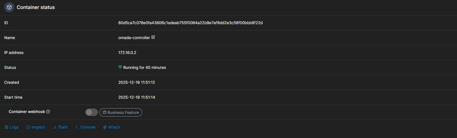

I launched Portainer, and it shows the container logs and information that my hardware does not support AVX instructions.
Edit
I launched version 5 via Portainer, and I think it will work fine.
