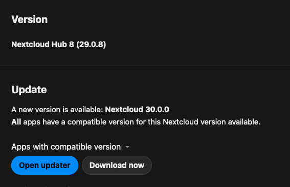

I will move to NC30 over the weekend. Now something i noticed when i update NC and this always happens: the update times out on the backup step. i don’t know why that happens but when use the back button in the browser and try again a couple of minutes later the updater allows me to proceed. Not sure why that is though.
You are not supposed to use the web updater for any seriously large installation but the occ commandline tool or for a major version the updater.phar. It’s in the Nextcloud docs. :wink:
I wouldn’t call my installation “seriously large”. I don’t run any apps on it and have about 5 users of which only 2 very active, my accountant and me.
But me being lazy and you being all-knowing on NC in a TrueNAS Core environment, how would i go about if i would want to use updater.phar? Would it still be sudo -u www-data php updater/updater.phar?
Well, i am not the waiting kind once i made my mind up and just executed the command. Works perfectly fine. On NC30 now. Seems cool. Only bunches of log entries related to some bugs with the Whiteboard.

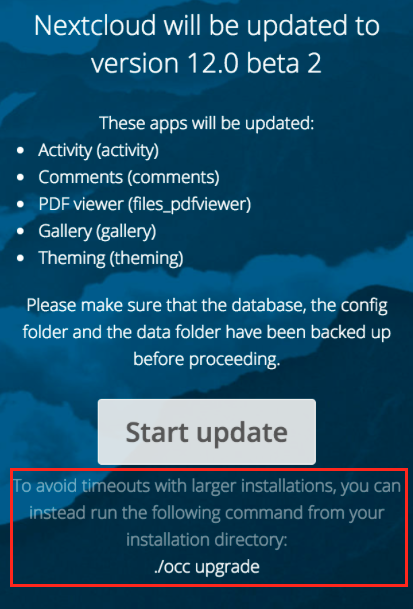

This has been in the Nextcloud UI since forever:
:man_shrugging:
My installation wouldn’t be considered “large” so that’s probably why I’ve been ok.
There doesn’t seem to be a difference between using the GUI and using the CLI, except for the timeout part. The actual commands would be the same I think?
Absolutely. The UI just has a good chance of running into your PHP-FPM (or equivalent) execution timeout, so using the CLI is always recommended.
