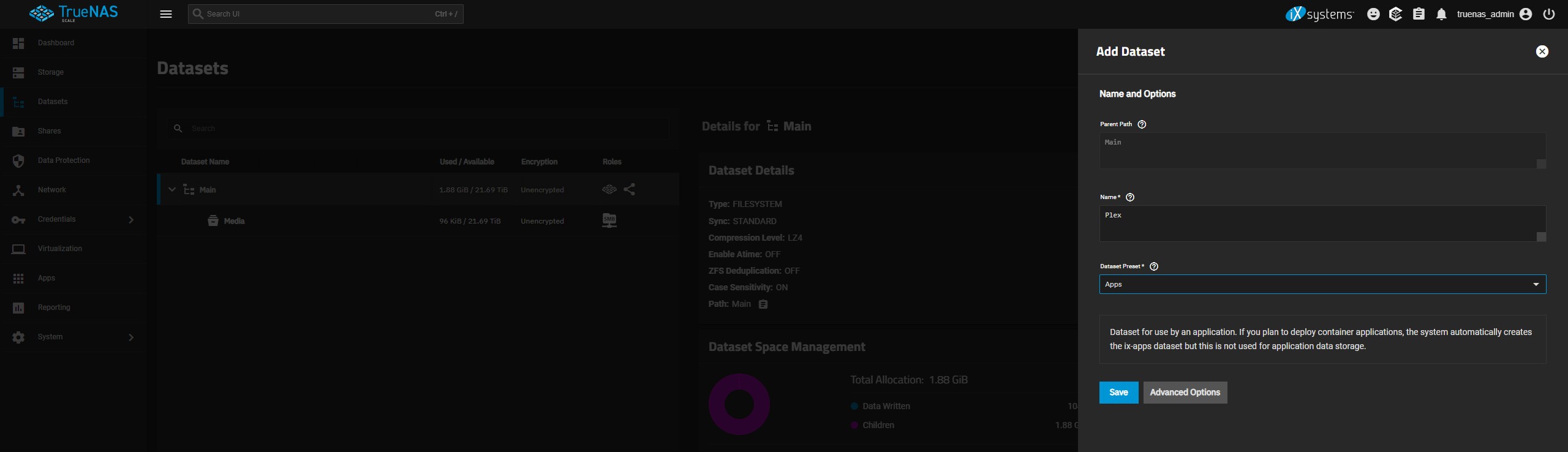

Dataset :
I created a “Media” dataset:
Another one called Server with Plex and logs as children :
Same manipulation for the child dataset “logs” by choosing dataset preset “App” "also

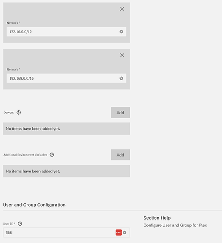

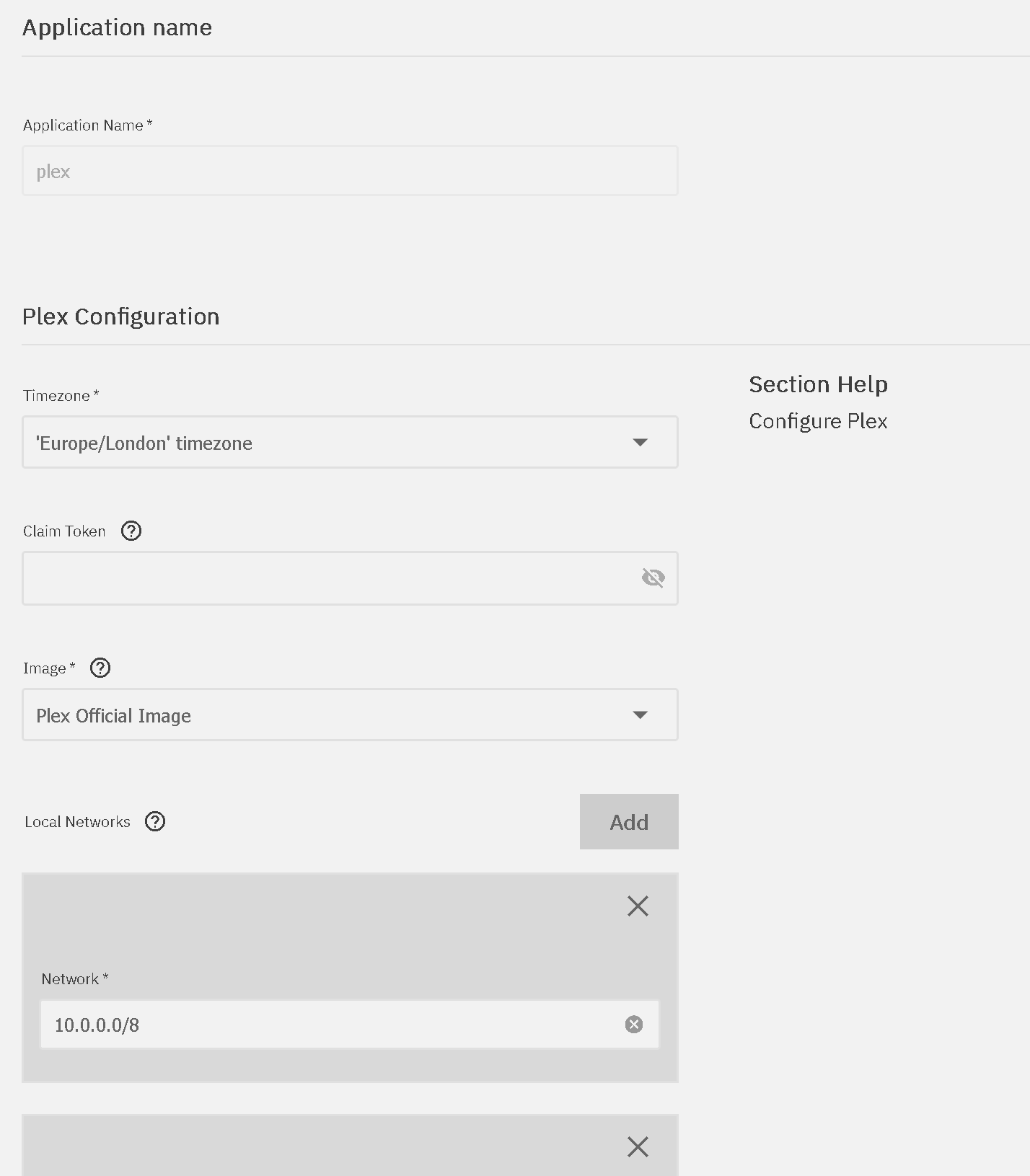

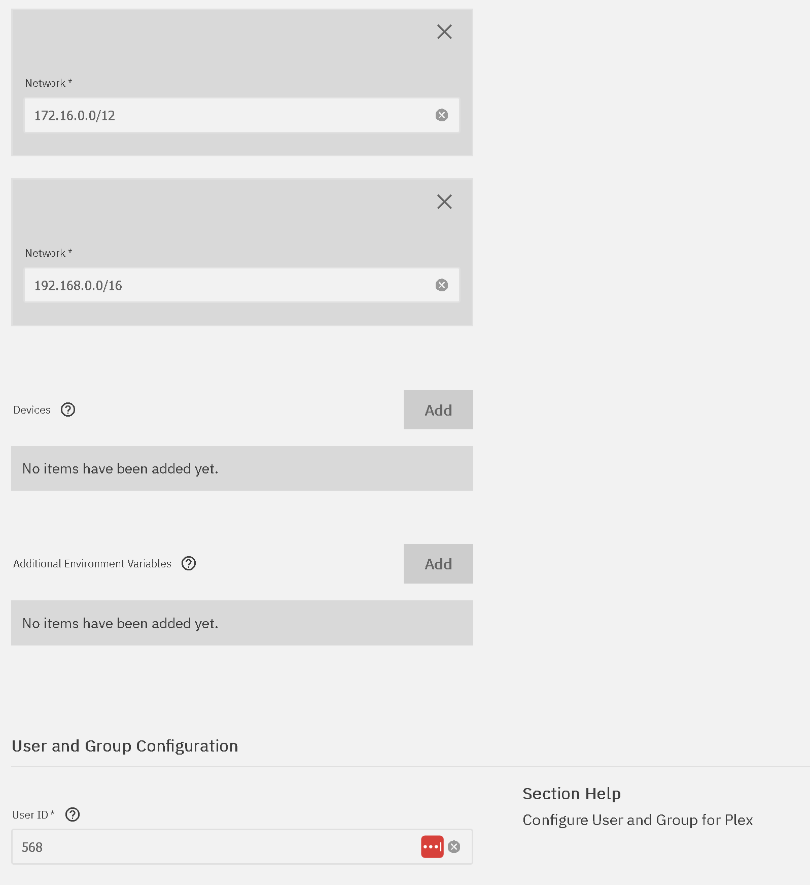

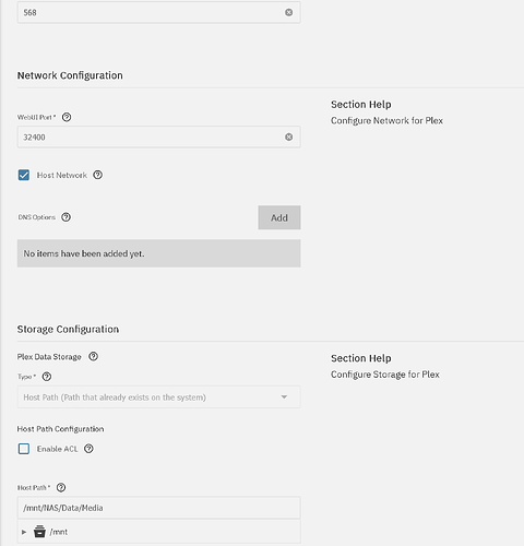

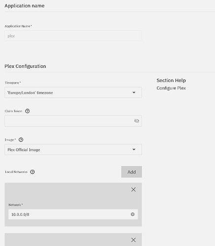

My Plex config is as follows…
When setting up libraries, click on config on the left of the browser and the individual media folders can be seen listed on the right
Hope this helps

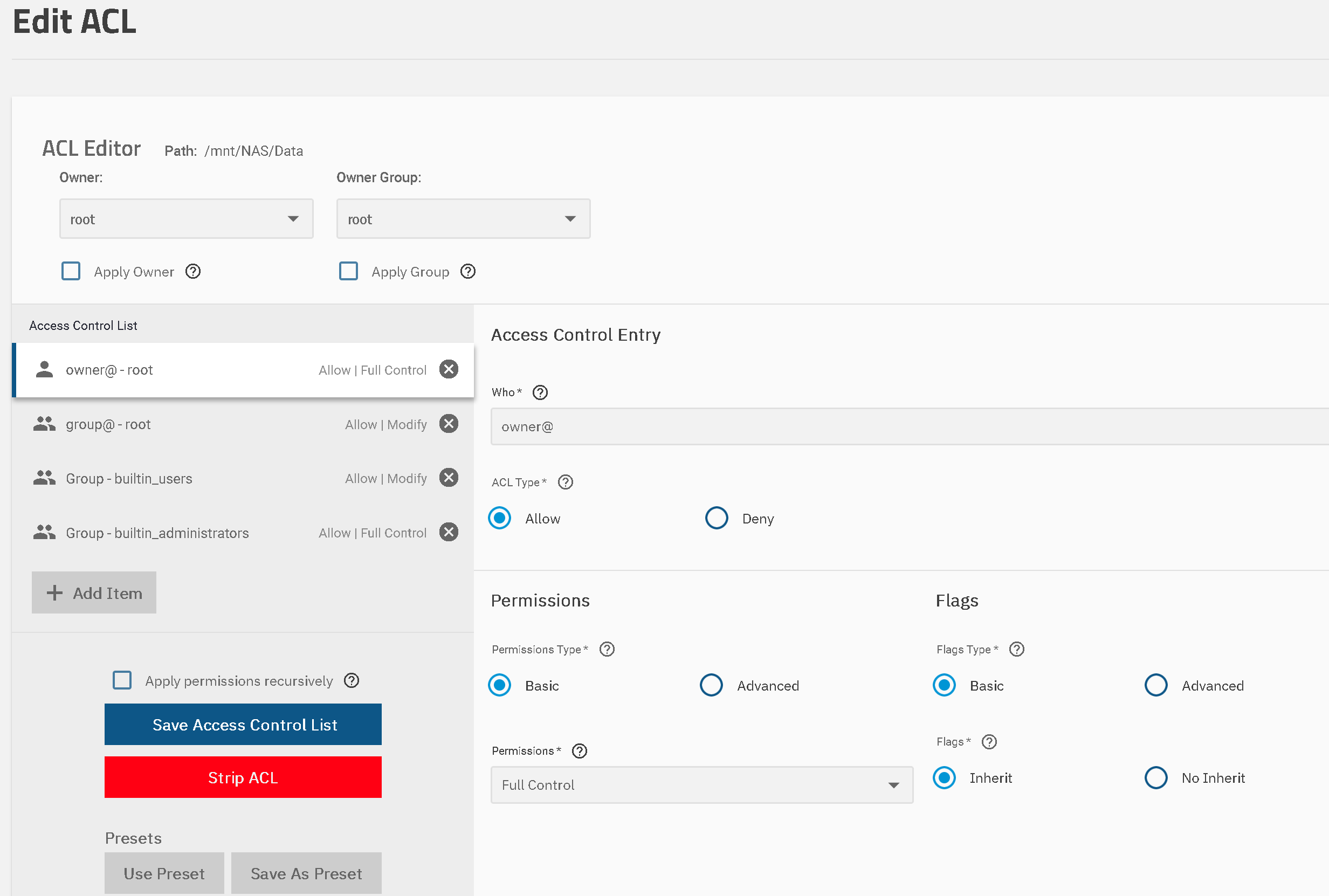

I haven’t made any specific group or user for plex and just use the built in users & groups as shown below. When the dataset was created I just chose smb as the share and left the permissions as default.
I have created users within the plex server and grant access to each individual plex user. For my use case my family members have access to all libraries except my music library.
