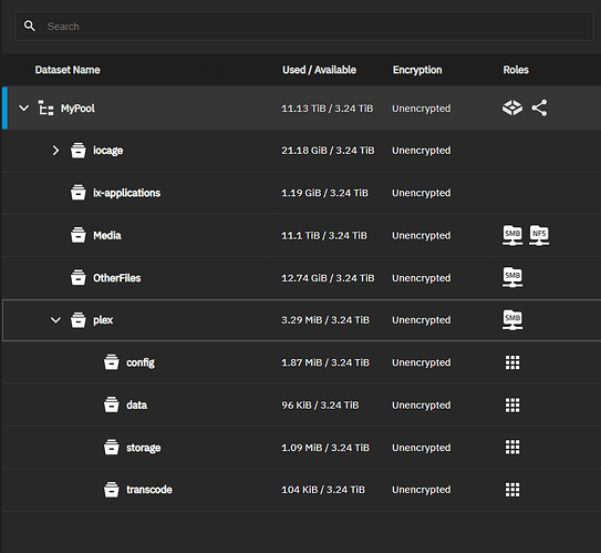

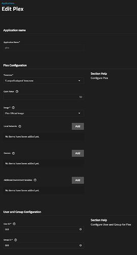

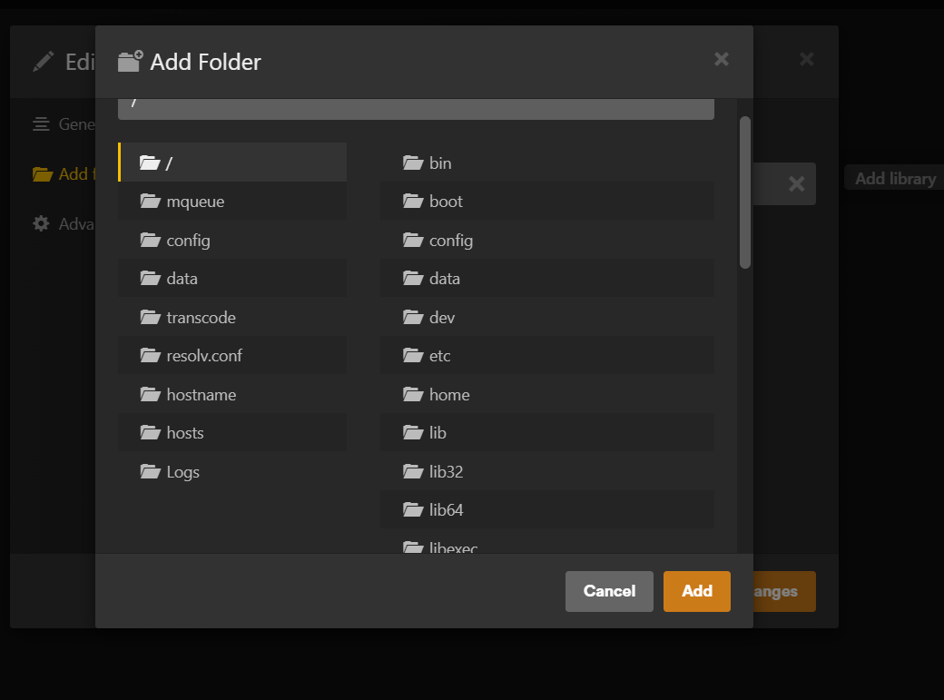

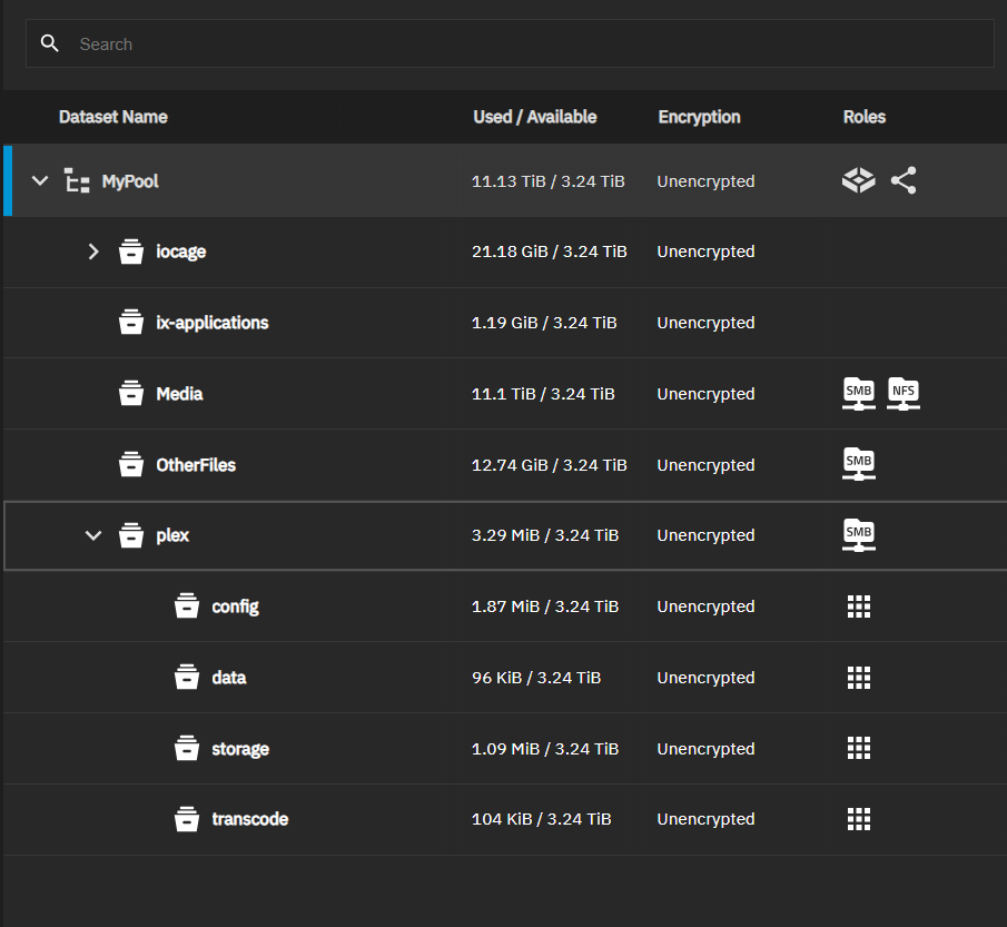

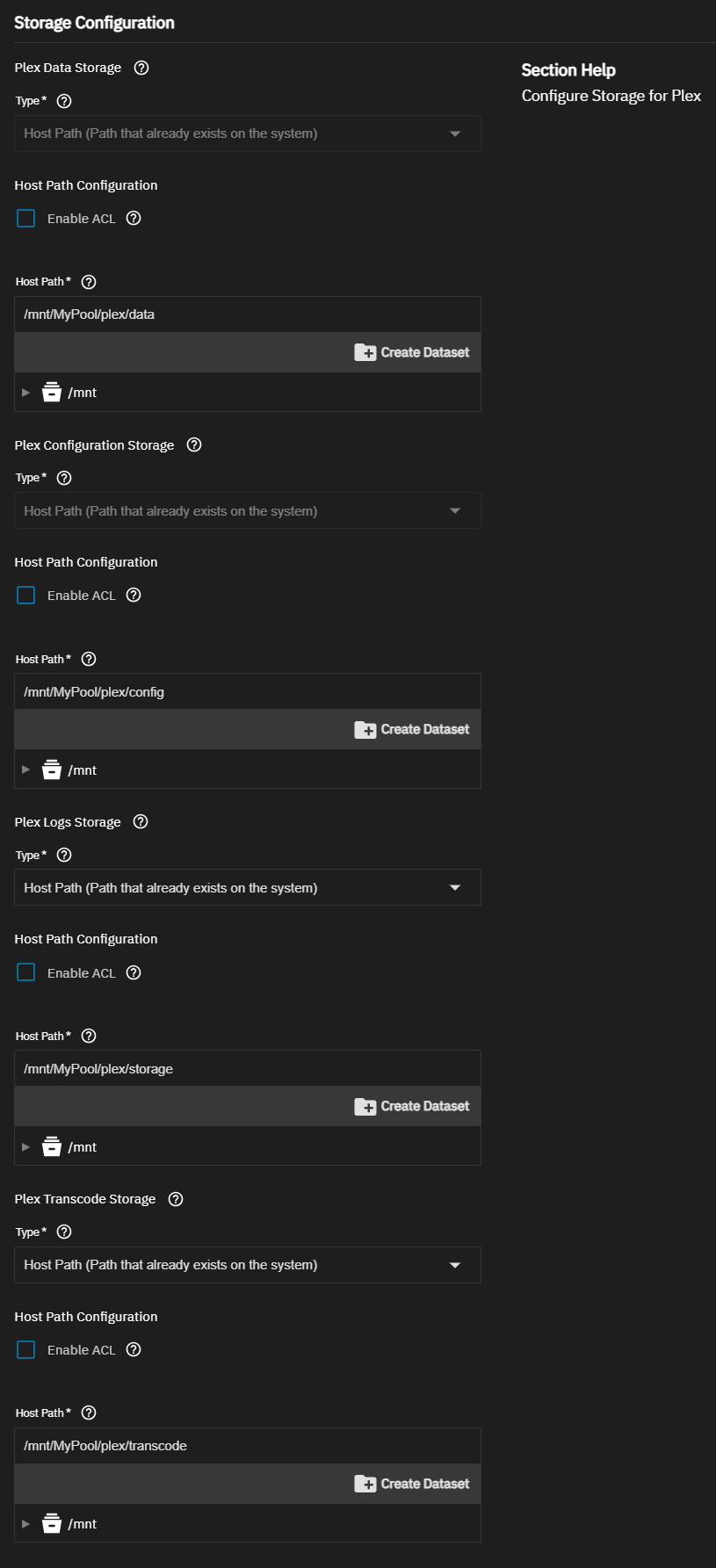

ow I’ve installed the Plex app to TrueNAS Scale but when I run the web UI I can’t add my media folder in server setup (libraries) because it doesn’t appear on the list. The Scale datasets, the Plex setup and the problem are on the pictures
. Where did I make the error?
Now I’ve installed the Plex app to TrueNAS Scale but when I run the web UI I can’t add my media folder in server setup (libraries) because it doesn’t appear on the list. The Scale datasets, the Plex setup and the problem are on the pictures

    The problem: I can’t add my media (in the libraries) because it doesn’t appear on the list.
I can only provide info on what’s wrong based on your screenshots, as mentioned above this is really scattered about.
Your current setup:
Plex Data: MyPool/plex/data
Plex Config: MyPool/plex/config
Plex Logs: MyPool/plex/storage
Plex Transcode: MyPool/plex/transcode

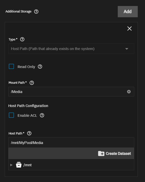

Where is your media stored on TrueNAS? Have you added a host path for this in the ‘Additional Storage’ section?

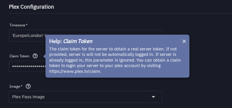

I also noticed the claim token field is empty. Have you gone through the claim process?

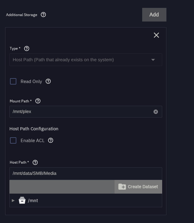

The Additional Storage now:
I’ve already claimed the server.
There’s no need for this. I mean, you can, but you don’t need to. Point “plex data” to whatever directory/dataset houses your media and be done with it.
Your media folder is intended to be (if you’d looked at the guide I posted in my first reply to this thread) the “plex data” path. Whatever’s in there (in MyPool/plex/data, so that’s where your media should be) is mounted at /data inside plex. As, again, I explained in the guide linked in my first reply in this thread.
Considering MyPool/plex/data was already configured & their media folder doesn’t show up, I’d assumed[1] they had read your guide and had pre-existing media in another location (from the core->scale migration) they wanted to add in addition to the dataset they’d created, though more than likely just me reading too much into it :slight_smile:
  1. When you assume… ↩︎
Fair enough. In OP’s case, the MyPool/Media dataset should probably just be mounted as the “plex data” location, as there’s nothing in plex/data. But, as you say, it’s certainly possible to have media in multiple locations.

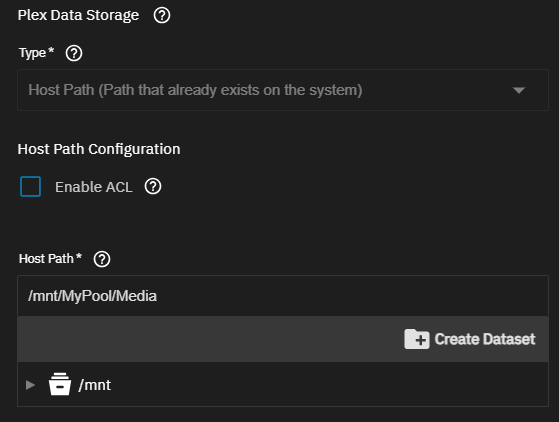

I changed the “plex data” location in edit:
The media folder still doesn’s show up.
Please tell me what do I do wrong. I’m desperate (and far more dummy than I was at the beginning :)))
