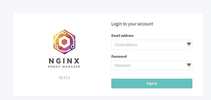

hm got the nginxproxymanager to load
will try that angle since i couldn’t get traefik ui to load.
another reason to go for nginxproxymanager, it supports using letsencrypt to get a valid cert renewable and still works for a lan setting. whereas traefik with makecert can’t do that.
this is how you set it up
Ok, got nginxproxymanager to work after hammering at the problem.
first issue was wrong docker compose setup. i was rewritting it until i got a working configuration and deployed that.
Next was the cert issue. I had issue trying to get the cert.
I later noticed duckdns ip was incorrect, so i updated that, refresh to check that it stuck, then repeated the lets encrypt cert generation and it finally worked.
then i added the host within nginxproxymanager, and tested it working
so what does this do.
Gives me a domain name (i use a free one, but you can purchase if you want to), get a green lock sign for a https cert that is validated, so you will stop getting bombarded with warning signs about invalid certs.
was unfortunate i could not get traefik to work. though tbh, even if i did, i’d have a worse situation compared to just using nginxproxymanager. because i could setup fine on npm but not traefik for the lets encrypt cert (i sus it will work but i haven’t succeeded with that before).
Also it’s just easier to setup.
If you are wondering, this setups is safe. it doesn’t open you up for attack. it’s local dns lan only using the domain name.
