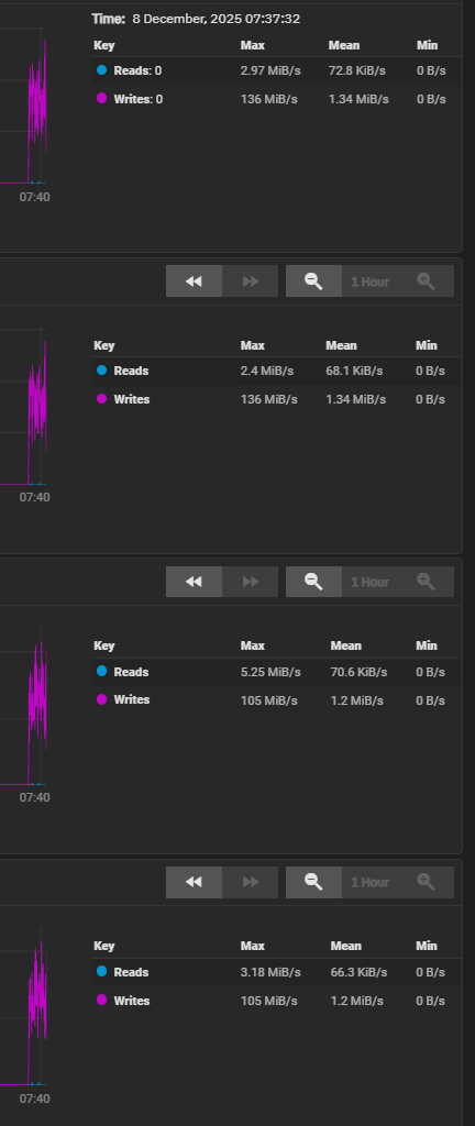

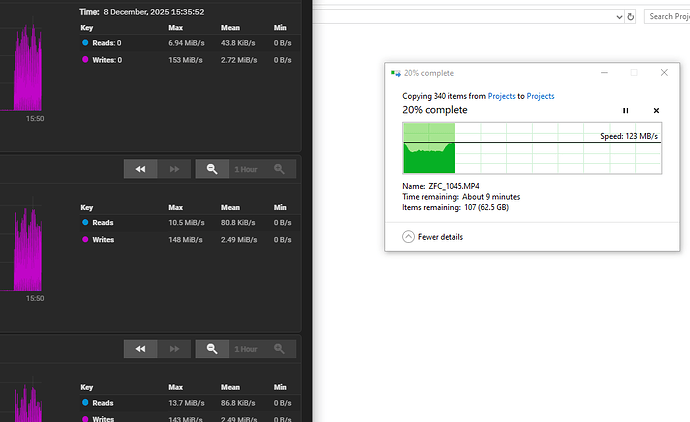

I’ve now removed the four 1TB drives (2 small mirrors) to see if they were causing problems (I was seeing they weren’t being written to all the time (which I guess makes sense, being that they are significantly smaller drives)). Speed is 130-150MB/s now. This is what the 4 remaining drives are doing during this write test:
Are these numbers indicative of a drive-bandwidth bottleneck?

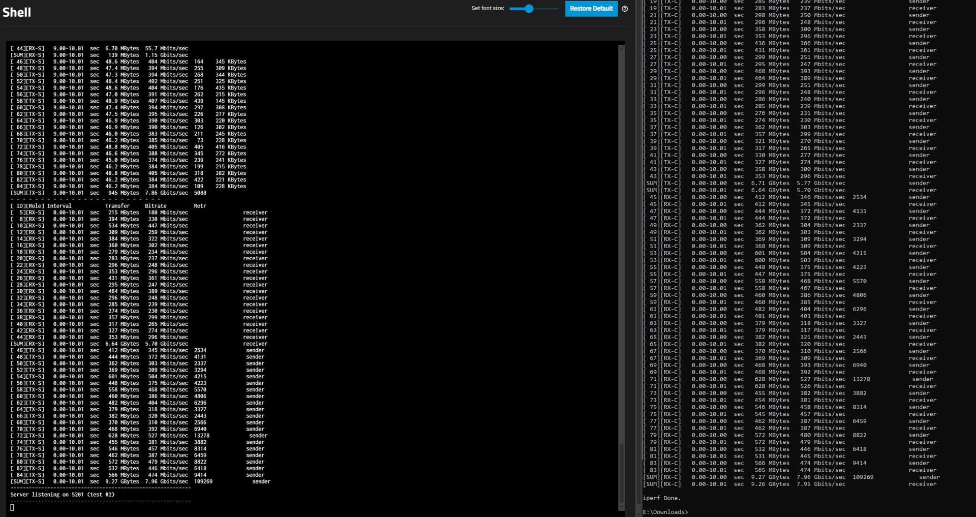

Did you perfom iperf3 and fio tests to determine if its a network or pool bottleneck?
Doesn’t look to be a network bottleneck… Left is TNS, right is Windows desktop:
I assume the high number of retries is because I’m not using jumbo frames.
Jumbo frames and mtu changes are not necessary at these speeds. At least they did nothing for me but cause trouble. Default mtu, default frame size got me around 9gb/s but that’s only if the arc is engaged. Basically dealing with the ram cache. When I lean on the actual array, I max anywhere from 500-350MB/s sustained (so about half of what the iperf can do with the arc).
Your pool types matter here too, but ideally you want to make sure your arc can learn to cache a big file or iso. You can encourage this by copying the same file over and over until it just magically gets cached, one direction, pulled from the server, not pushed.
Finally, SMB is kinda bad for testing due to it mainly being single threaded and cpu heavy. If you can use something like ftp or nfs those are better for testing.

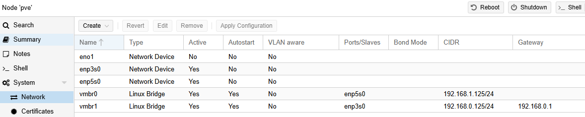

Can you post the screen of your proxmox network page?

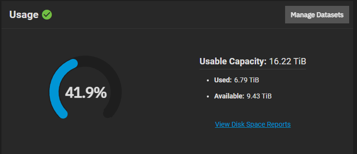

What is your pool occupancy?
