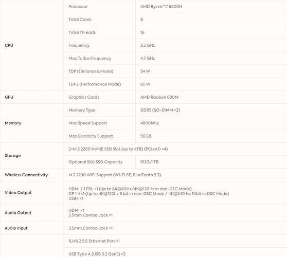

@mlinko6 Please post details of your hardware - we have had a couple reports from users with older devices that have exposed some edge-case issues on the newer kernel that required disabling IOMMU or similar.
There are the specs:
CPU: 24GB Ram
GPU: 8GB Ram
If you need anything else let me know.
That’s definitely not older hardware. What are you using for a boot device?
