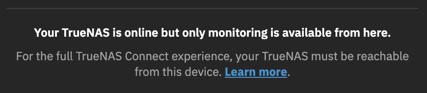

Follow up, after some time, I was able to add this TrueNAS to Connect, however it does not seem to be completely available to the web console.
i see the same message.
i have my main system at home and my second system off-site. both systems have tailscale container running.
i can reach both systems directly on their respective hostnames but for me connect says it can’t reach the off-site system.

Can you verify TailScale connectivity?
It is persistent. Both have TailScale installed and running, no exit node, no subnet router just a node on my TailNet.
If Tailscale is working for direct connection to your NAS… it should work.
