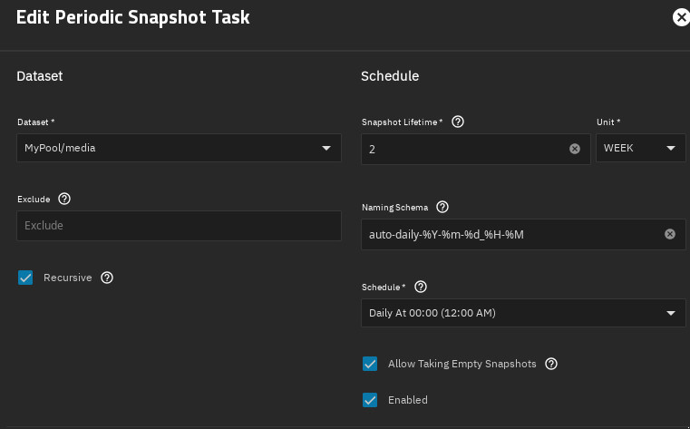

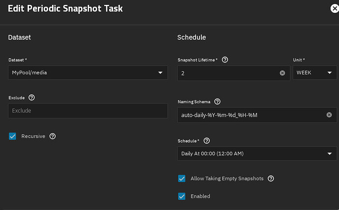

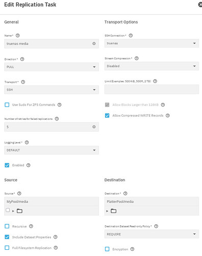

You’ll have to show us screenshots of the Snapshot Tasks and Replication Task. You can redact personal info.
Daily & weekly snapshot tasks

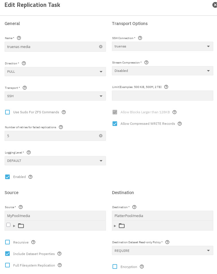

Replication tasks
You’re going to have a headache with this setup because your source contains two different snapshot tasks with different frequencies, naming schemas, and expirations. This works without issues for managing snapshots, but things get messy when you try to include more than one Snapshot Task or naming schema in a Replication Task. ZFS incremental replications cannot backtrack to leap over existing snapshots that were already replicated.

I notice you have “Replication From Scratch” enabled, which means you’re telling TrueNAS to destroy the dataset on the destination and start all over if needed. This is not ideal.

I wasn’t sure what to do for that setting. I would like both systems to be in sync.
